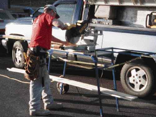

I use a miter saw almost every day, but until recently I'd never owned a really satisfactory stand. The homemade stands I've tried over the years were invariably heavy, bulky, and difficult to move around, so I usually found myself setting up the saw on the floor and using 2x4 blocks as stock supports. Although that produces good results, it's both inefficient and hard on your knees and back. I finally decided it was time to invest in a good manufactured saw stand.
As a remodeler, I need a stand that's versatile enough to handle both my 10-inch Delta compound saw and my 12-inch DeWalt sliding saw. Changing from one saw to another has to be quick and easy, because I need to do that fairly often. The stand also has to fit in the back of my truck and leave room for tools and materials. Finally, it must be rugged enough to handle the weight of long joists and rafters, not just lightweight trim.
As I began shopping around, I quickly learned that the term "miter-saw stand" means different things to different people. Some manufacturers classify universal tool stands and portable workbenches as miter-saw stands, even though a professional builder would be unlikely to use them in that capacity. For this article, I decided to zero in on dedicated portable miter-saw stands that could handle a variety of saws, transport easily, and stand up to contractor use.
I found nine stands that seemed to fill the bill. They all promised to fit most saws, and they represented a variety of price points. They looked as if they'd be good at most miter-saw tasks, and while they offered varying degrees of portability, all could be moved fairly easily by one person.

As a remodeler, I might be on two or three different jobs in the course of a week, so I need a lightweight stand that sets up quickly. The DeWalt filled the bill on both accounts, and it's a purchase I've been very happy with. I can carry the stand by myself without bashing holes in the walls of my customers' homes, and it fits in my truck bed with some room left over for building materials. The saw base's quick-release clamps work well, and with an additional set of clamps I can mount my other saw without a hassle. The stock supports and saw base are flexible in their placement, and the stop system works better than those on other lightweight stands.
Carpenters who work on bigger projects with no portability or space restrictions would probably find the Sawhelper, Trojan MS2000, or Rousseau the best tool. All three handle heavy loads and have ample surface area to support bigger stock. The Sawhelper was my favorite of these. It handles long stock and comes standard with the best stop system of any of the stands I reviewed.
In my opinion, the value winner is the Trojan Workcenter. It's inexpensive, light, and sturdy, and its components can be used separately for other tasks.
