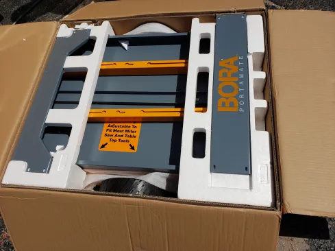

The Portacube ships disassembled. Assembly is reasonably easy. Fine-tuning the adjustments are a little more finicky.
Cliff Woodman

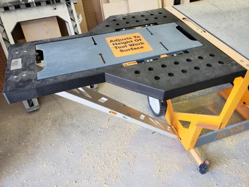

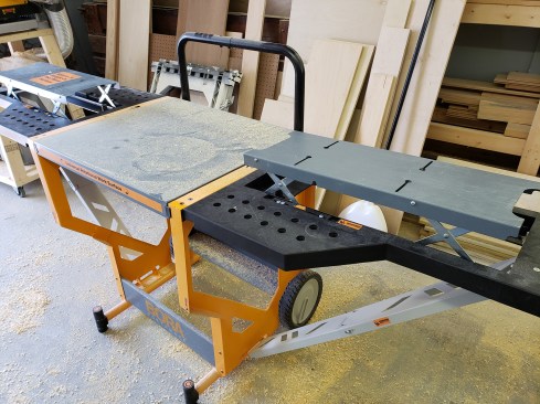

First, the basics. Once I had it assembled and set up inside the building I was working in, it was great to have the flat work space available. Since I had no way of locking it up at night, I did not actually bolt my miter saw to the unit, but instead just sat my smaller saw on it and adjusted the risers on the left and right to match the saw’s deck height. It worked well like this and it was nice to have the extra space for a tape measure, pencil, notes, and the like. It even served as a plan table. The two wings are easily lifted into place to give you approximately 7 feet of work surface and then easily lowered when not needed. The 10-inch wheels made it easy to roll around,and with a working height of 34 inches, it’s comfortable and stable.
With the wings extended, we had about 7 total feet of level working space.
Cliff Woodman

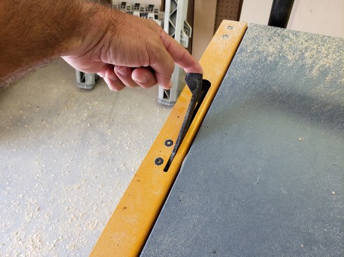

All told, this is a great concept and we got a lot of use out of it, but maybe a couple minor tweaks could streamline Portacube’s performance. It obviously has been designed with mobility and shipping costs in mind (small boxes are cheaper to ship than big ones), which is evident in the assembly design.
This lever was impeded when the unit racked, but otherwise worked well.
Cliff Woodman

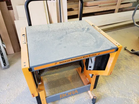

The 10-inch wheels are nice, and the unit is heavy but mobile.
Cliff Woodman

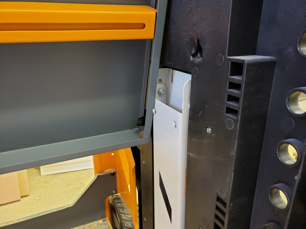

The unit I got needs to be set up on a flat floor so its fold-away top deck can fold away. If not, the frame racking causes pinch points.
Cliff Woodman

I did have a couple of problems rotating the top of the unit when the unit was not sitting perfectly flat and level. It has a tendency to rack just enough that the table can’t spin. Possibly a couple more strategically placed braces might fix this. It would be significantly more stable when deployed and could be used on jobsites as well as in the shop. I also had a little trouble with getting the handle to slide up and down due to this misalignment. Again, I think a welded solid unit may be better overall.
