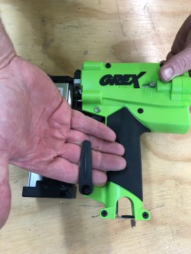

With the sales slogan of “Size Matters,” the new Grex GCP650 pinner is a perfect fit for the work I do. At under four pounds and cordless, this pinner is perfect for the shop or the job. Don’t be fooled, though; this gun packs a punch. I used it in hardwood (white oak) and softwood, and it didn’t flinch.

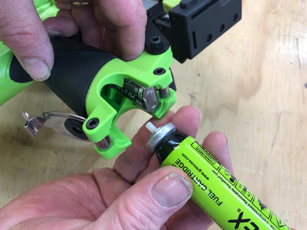

When I was doing trim work or assembling glue-ups, it performed extremely well, from fastening dentil molding to temporarily fastening patterns to pieces I scroll cut with the router. Running off of two AAA batteries and a fuel cell keeps it lightweight and compact, and it requires minimal maintenance. Both the battery and the fuel cell are in the handle and easy to change. Needless to say, it has no compressor and hose to deal with, so time saved. Seeing the fasteners is easy through the window at the nose of the gun. Also, with the dry-fire lockout, there’s no need to back track over your work to see where the gun started shooting nothing into the work.
The tool—which I used mainly in my shop but also on site building a coffered ceiling and a mantle—shoots from 3/8- to 2-inch fasteners and is a versatile tool to keep around. Setting the depth is as easy as sliding the depth knob.

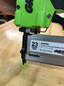

With the non-mar tip, which is removable, the nose of the tool won’t ding your work. There is a back-up tip stored on the tool as well, opposite the belt hook, which I also like and think is well designed. I also like that the nose assembly is slim for fastening in tight spaces.

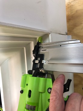

The nose is compact, enabling me to fasten in tight spaces.

The belt hook is great. On the opposite side of the tool, there is an extra no-mar tip.

At 1,300 shots per fuel cartridge and 5,000 per batteries, it’s made for performance and didn’t leave me hanging.
