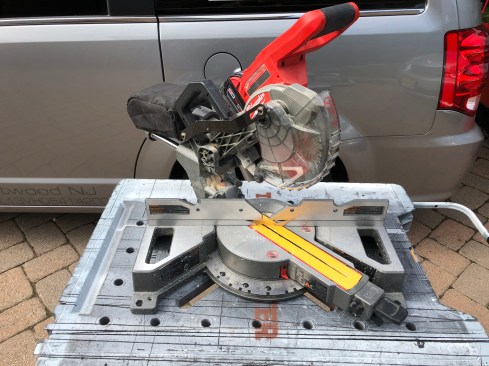

Out of the box, the tool was accurate. Assembly was pretty much take-it-out-of-the-box-and-go. My first impression was the saw was light and seemed well built. The stock blade was a nice one too; not what I consider to be the usual throw-away framing blade on a trim saw.

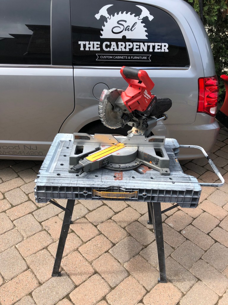

I used this saw on all my installs for three months, mainly with prefinished materials that I fabricated in my shop along with some on-site trim. Because I’m usually set up for a couple of hours at any given time, my saw setup isn’t elaborate: I use a standard miter saw stand with extension wings that have some minor adjustments to suit my work flow. Most installs require anywhere from two to hundreds of cuts and on each job I was able to get the whole job done without draining the battery fully. Once, I didn’t charge the battery for more than a week!

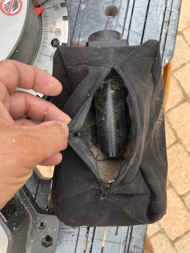

The dust bag is a decent size and not easily clogged at all. This unique interior chute is cool.

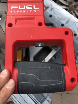

The saw is easy to adjust. It took me just a couple of days to get used to the location of things because the layout is different from that of my old saw. The biggest obstacle for me was my muscle memory for the head lock push pin. I can’t seem to adjust to it being on the left side of the head while it is on the right side of every other saw I have used.
The shadow cut line indicator was dead accurate.
Another feature—that I love—is the shadow line blade indicator. I have lasers on every saw I ow,n and they all have little quirks to their accuracy. However, the shadow line is flawless. You know right where the blade will cut. You can even hit a little button by the trigger to kick the light on without having to spin the blade first. It’s visible in daylight but harder to see in direct sunlight (as are lasers.).

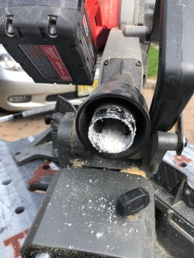

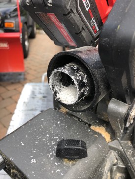

Doing this also pretty much side-steps effective dust collection. This is the case with most saws and this one isn’t much different. The dust bag is a decent size and doesn’t get clogged easily. I like its unique design, which utilizes an internal tube and deflector. Hooking the saw to a vacuum was an improvement but not much. It was OK with me, since I had the saw set up outside of the home anyway.
The author's method of kerfing negates much dust collection on this and other saws he has used. He usually sets up outside, so it’s not a problem for him.

The weight of this saw is fantastic at only 28 pounds. As I age, I appreciate lighter tools. This unit is a one-handed carry, which means fewer trips to the van. It’s handy to carry to the work when needed, which is not the norm for me as I work mainly in finished homes.
