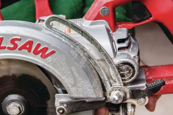

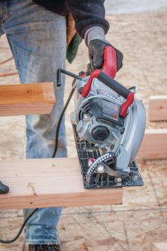

Though very much a Skil saw, the Mag 77LT has a number of features that distinguish it from previous models. Upgrades include a 53-degree bevel capacity (the Mag77 topped out at 51.5 degrees), a rubberized grip and top handle, and a storage spot on the baseplate for the blade wrench. The wrench is designed to change blades, adjust the bevel nut, access the brush cap, fit the oil plug, and remove diamond arbor knockouts. The new saw is very compact, about an inch shorter than my DeWalt.

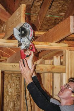

The saw arrived while we were framing a house, and the first thing we used it for was cutting birdsmouths and rafter tails on about 50 rafters. We immediately noticed how much lighter it felt than most other models. The saw’s 15-amp motor has plenty of torque and didn’t bog down when we cut LVL.
I like almost everything about this saw, but I do have a complaint about the depth-adjustment mechanism. Once you’ve dropped the saw (and sooner or later you will), the depth adjustment gets sticky and you have to tap the base with a hammer to get it to move. This has been a problem with every Skil wormdrive I’ve used. It’s a nitpicky concern but one that has annoyed me for 20 years. By way of comparison, our DeWalt has taken a number of falls, and after three years of use the depth mechanism sticks only slightly.
