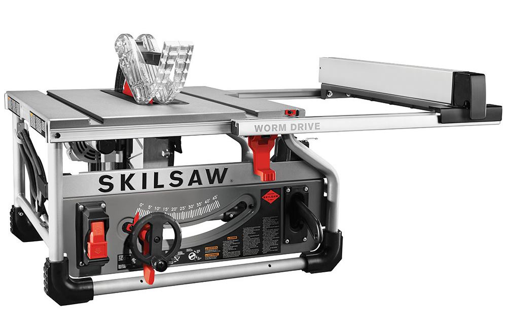

When I first lifted the Skilsaw worm drive table saw I was impressed by its light-weight and easy handling. At 51 pounds and with a table size of 23 1/2 inches wide and a mere 20 inches front to back, this is a compact job site table saw – as small as the “flooring” table saw class, but somewhere in between that and a standard size job site saw. The Skilsaw could undoubtedly be attached to aftermarket stands, but in keeping with the saw’s small and simple demeanor, I tested it on the brand’s optional folding stand (model SPTA70WT-ST).
The unique thing about the Skilsaw is that it’s the first table saw powered by a worm drive motor–the same motor found on the circular saws the brand is famous for. Users unfamiliar with worm drive motors will have to keep in mind that this saw has a gearbox filled with oil that must be checked and changed out at specified intervals. The manual instructs that the oil should be changed after the first ten hours of use, and then every 60 hours thereafter. With no hour meter on the saw, you must estimate these times or just follow the manufacturer’s suggestion to change the oil at least once a year for heavy use. Ordering extra oil with the saw is the sort of thing that’s easy to forget so it would be helpful if the saw came with a bottle for that first ten hour oil change at least. That milestone can come pretty quickly if you use the saw regularly.

    Once calibrated for accuracy, I put the saw to work. The Skilsaw did a respectable job cutting small, angled-tenon bridle joints, but I felt like I was reaching the limitations of this saw’s finesse with this precision joinery work. Besides, more of a challenge was in order for a saw wearing a Skilsaw nameplate. Cutting sheets of OSB isn’t much of a workout for most table saws, so besides that common job, I ripped over 1/4 mile of 2-by lumber (including 2x8x16s) and spent hours ripping hundreds of linear feet of 4x4s with the saw’s blade fully buried in the wood. Under these conditions, I was impressed by the Skilsaw’s power and stamina. Over the many hours I ran the saw in a day–sometimes over an hour at a time without turning off the machine—I never heard the saw slow or falter or smelled anything “hot” that would have been cause for alarm. The Skilsaw worm drive motor is a great fit for this saw and delivers heavy duty performance as promised.
    During testing, I had trouble with the wood getting pinched against the back of the fence, and it began to require so much feed pressure that the saw and stand began tipping. I assumed I had a problem with the fence. But after fiddling with it for quite a while, I figured out that riving knife was misaligned. Since I had spent so much time adjusting the riving knife before putting the saw into service, I didn’t suspect it to be the problem. It turns out that the mounting bolts were still tight, but the mounting plate must have slid over. Also, when I removed the riving knife and checked it with a straightedge, the back edge was slightly bent, but it was easy to straighten and realign the whole asembly. This minor setback taught me one more thing to look for in a pinch (literally) but didn’t lower my confidence in the Skilsaw. After all, I was working the heck out of the thing with some pretty big pieces of wood.
    On a similar note, and more of an observation than a concrete test result; I’m bothered by the amount of play found in the trunnion mounting assembly behind the blade. This came to my attention when I noticed that tugging gently on an attached vac hose really wiggled the angle of the blade and riving knife. And with the leverage of a partially cut board straddling the blade and riving knife, the angle can really be tweaked, whether accidentally or not.
    This movement is caused by the way the saw’s bevel angle is adjusted and locked down. The blade pivots by way of curved slots in the trunnion mounts at the front and rear of the saw, but only the front is held in place by the locking lever. The floating rear assembly remains free to move with little force so it seems as though a simple rear lock would be the solution to this undesired movement of the blade. I couldn’t determine what kind of inaccuracy this movement may cause in different types of cuts, but the wiggle is a legitimate gripe that costs the Skilsaw a few points off its finer woodworking side.
