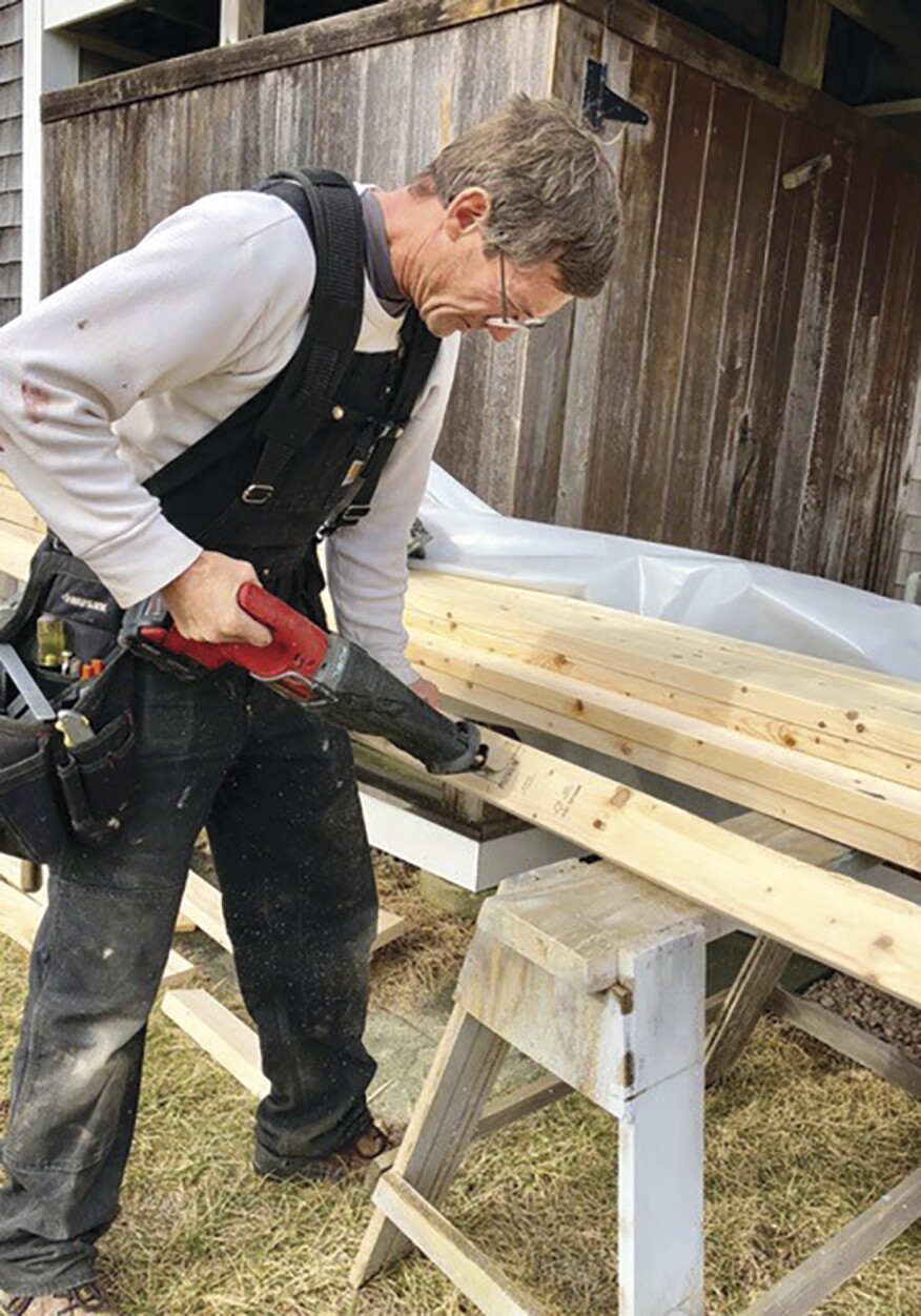

Demolition. A recip saw is a great tool for destruction, although I’ve had to show many people that an old circular saw will make most demo cuts much faster and more efficiently if you have access for using it. (There are few things that frustrate me more than seeing someone spend 10 minutes making a cut that I can do in 10 seconds with another tool).
A recip saw makes quick work of removing a stud without damaging it.

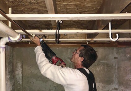

While not making as clean a cut as a tubing cutter, a recip saw can cut through pipe quickly. If the pipe happens to have water in it, the cordless version makes cutting much safer than with a corded saw.
Cutting pipes, wires, cables, bolts, rebar, and other odd material. With the right blade, a recip saw can cut almost anything and often in the most hard-to-reach places, such as a foundation bolt in a narrow bay. I’ve also used a recip saw to slice into existing copper pipe. While a tubing cutter might make a smoother cut, the recip saw can make a quick cut in a pinch. And the cordless version might be appreciated if there is water in the pipe. For some of these jobs, a recip saw might be the only tool that works.
