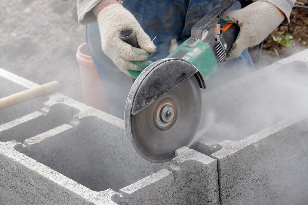

Inhaling silica dust can lead to silicosis, which is an incurable lung disease. Excessive exposure to silica can also lead to lung cancer, kidney disease, and pulmonary disease. Where does silica dust come from? On most residential jobsites, the dust is produced from grinding and cutting concrete, stone, and brick.
