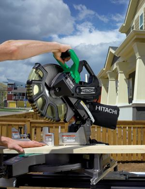

Performance and Cutting Capacity. Without a doubt, the Ridgid out-cut the competition in terms of overall width capacity. It was the only saw that could cross-cut a 2×10. I’m no engineer, but I believe the blade center being farther away from the fence is the reason. The Ridgid will cross-cut up to 9-3/8 inches at 90 degrees without tilting up the front of the workpiece. I measured the others as follows: Hitachi 8-/16, DeWalt 8-1/8, Makita 8-1/16, Bosch 8, Milwaukee 8, Ryobi 7-15/16, and Craftsman 7-3/4 inches.
When I tested cross-cut capacity on a 4×6 timber, set wide end down, every saw except the Ridgid cut all the way through. The geometry that makes it a wide, flat cutter works against it with a taller block.
No saw could cut through a 4×4 at a 45-degree bevel angle, nor could any cross-cut a 6×6. The capacities in the specs (page 36) are based on the widest and thickest pieces that could be cut laying flat. Much taller pieces can be cut vertically against the fence, but that height depends on the board width.
For my time trials, I aggressively cross-cut 4×4 white oak post material using the stock blades that came with each saw. The fastest by far was the Makita, so if its performance is a 10 out of 10, the rest follow as such: Craftsman 9; Bosch, Hitachi, and Milwaukee 8.75; DeWalt and Ridgid 8.5; and Ryobi 8. As evident by the close scores, there is not a dog in the bunch. Any of these saws has enough guts to cut quickly and–if you treat them well–accurately, too.
