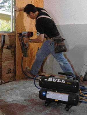

The Bull is light and small, so it’s easy to carry one-handed. The only unusual features on this tool are the stainless steel petcocks. This is a basic inexpensive compressor, though the manufacturer also produces a similar model (D2000HSSV5) with a higher quality pump. Associate Engineering Corporation 920/349-3281 www.rolair.net
