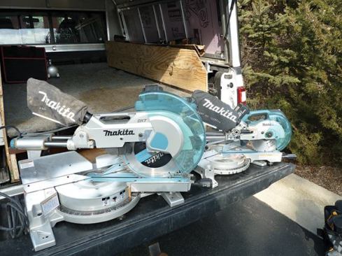

The LXSL01 looks very much like the company’s well-regarded 7-1/2-inch corded sliding compound miter saw, the LS0714. In fact the cordless saw appears to be a near clone of its corded brother except that it has a different handle configuration and a battery tucked behind the handle. The two tools’ size, capabilities, and included accessories are practically identical.
Certainly the new saw is as light and compact as the corded tool. According to Makita, the LS0714 weighs 28.9 pounds. We weighed the cordless version (including the battery and dust bag) and it tipped the scales at 28.4 pounds. The extension wings — which we rarely use — add another 2.2 pounds.

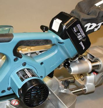

The lithium-ion batteries are very light — about half the weight of nicad batteries of the same voltage. The LXT designation refers to the fact they’re 3.0-amp-hour models, which provide twice the capacity of the slimmer, 1.5-Ah batteries that come with Makita’s compact (white) drills and impact drivers. It should be noted that the slimmer packs do not fit every LXT tool, but every LXT battery fits all of the tools in the 18-volt lithium-ion lineup.
Charging time is very reasonable; a pack can go from discharged to charged in about 30 minutes (unless the battery is hot). The charger contains a fan that blows air up through the battery to cool it, and signals the beginning and end of the charging cycle by sounding a chime.

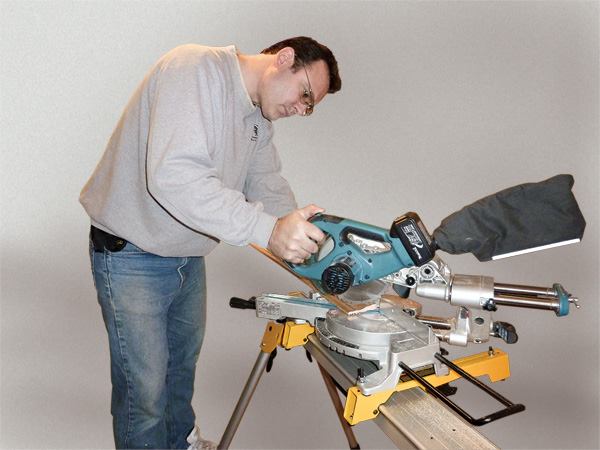

We used the saw to cut a variety of solid and engineered lumber products — pine, oak, fir, and composite — and were happy with its performance. Accuracy was excellent out of the box, with both miter and bevel cuts matching the settings on the scales.
If adjustments are needed, you simply loosen the screws on the pointers, alter their positions, and retighten the screws. To make more involved adjustments to the miter function, you loosen and reset the fences — an operation we never found to be necessary.
The miter and bevel scales are easy to read, with crisp white-on-black markings for every degree. The usual detents are cast into the miter table at 0, 15, 22.5, 30, and 45 degrees. The tool miters 47 degrees to the left and 58 degrees to the right — very handy.
It bevels to the left only, which didn’t bother us; we rarely need to bevel. (We might feel differently if we used the tool to cut crown on the flat.) The bevel scale is a bit small, but legible.
The saw does not slide quite as smoothly as other Makita sliding saws I’ve owned and used over the years. But this doesn’t affect performance, so it wasn’t a problem for us.
