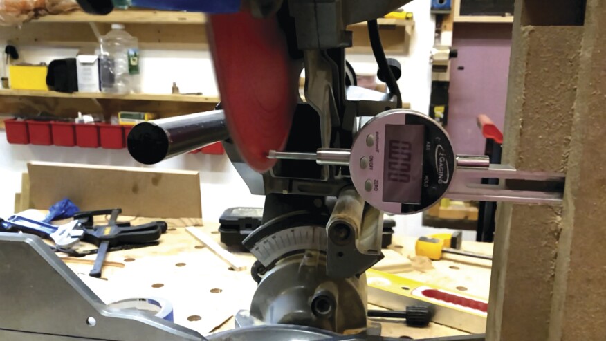

Blade-wobble results were verified by recording the running saw blade in slow motion, and then visually observing if the pin jumped around. Kerf cuts were made in 4-by material and measured with a caliper.
Blade Wobble
I tested each saw’s blade runout just above the gullet, noting the highest reading. For this to have been a purely scientific test, I would have needed to use a machined plate on each of the saws. But I didn’t have one available, and I also wanted to get real-world results that matter to carpenters. I tested blade wobble after the dust extraction test—when each saw was equipped with a 60-tooth Diablo blade. It can be argued that any given blade could have some variation in it. But the results were all so close and completely corroborated by visual observation that my method felt justified as a comparison.
All in all, they did quite well—with a couple of them not doing so well. Both Hitachis, the Kapex, and the Makita had no measurable wobble. This was confirmed in test cuts and in kerf cuts that I measured. The DeWalt had slight (.006 at the gullet) wobble but produced clean, perfect cuts. The Bosch and Delta had measurable and visible wobble, which showed in most test cuts.
