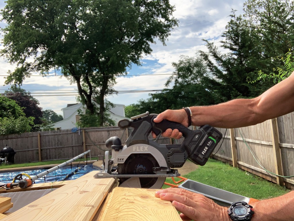

The saw is a bit of an oddball. It’s a sort of top-handle, sort of in-line, awkward/not awkward belt-drive battery-powered circular saw with a downsized 6 1/2-inch blade. Even so, it has become my everyday carry to the point that I feel awkward using anything else.

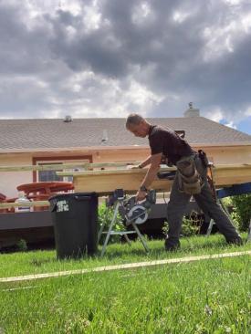

My primary focus is as a work-alone carpenter building decks and doing general remodeling activities. I cut enough pressure treated lumber that my blade teeth turn green. I’m primarily making square cuts, so I don’t need a tool that will cut deep bevels. But I do need a meat-eater that’ll cut my peculiar beam ends and rip soaking-wet 2-by PT stock—and not break my arm off while doing it.
Blade size and power. Even with a 6 1/2-inch-diameter blade, this saw cuts 99% of everything I need to cut: PT stair stringers, end cuts for joists and deck boards, gang cuts in composite deck boards off the stack (trimmed later with a track saw), long cuts trimming V-joint tongue-and-groove roof deckers or deck boards to length after installation. In fact, it cuts 99% of what I need cut with the base of the saw raised a little off the stock, which makes the blade guard roll easier. The saw is powered by a brushless motor that spins at 5,500 rpm. The included blade is excellent.
In use, the Flex saw reminds me of a couple of saws in the 5-inch range, including Porter-Cable’s beloved 314 wormdrive 4 1/2-inch trim saw (no longer in production), and Ridgid’s compact Fuego 6 1/2-inch sidewinder. While it is similar in some ways, it is also a lot different. For example, it has a belt drive that offers a plush start and quiet operation with about zero reaction torque.

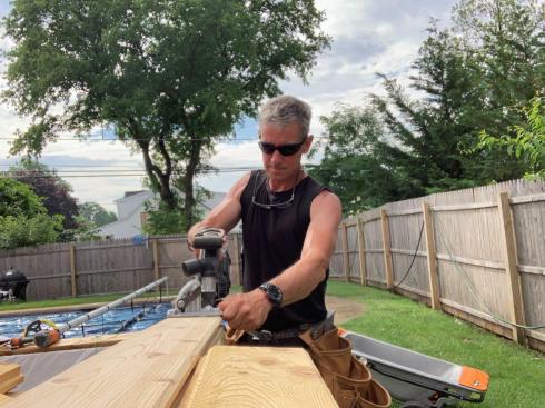

In-line, blade-left. During my time at JLC Live as a presenter, I discovered that I was cutting like a West Coast wormdrive user but giving myself scoliosis doing it because—as an East Coaster—I was using a sidewinder saw. Learning to cut with one of the wormdrive saws issued by the show staff was a watershed moment for me. With its blade-left design, the Flex saw offers many of the attributes of wormdrive cutting, minus the worm gear, 10 pounds of weight (the saw weighs 7.1 pounds without the battery), the power cord, and wrist twist on every cut.
Lines of sight to the blade are magnificent. The stout aluminum shoe is clearly stamped with the blade kerf and location; so well, in fact, that I actually use the shoe sometimes. Its thickness rides along my square (I use the square as a guide; such a labor saver and the cut is dead-on). Though I’m not gentle with the tool after the cut and let it hit the ground, it comes back square.
The saw has a blade-left design, a rafter hook, and an adjustable dust port that can be hooked up to a vacuum or swiveled to eject dust away from your cut line.
