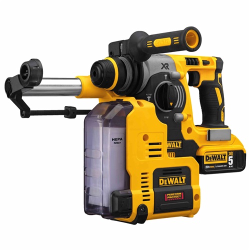

DeWalt DCH232P2 equipped with the DWH303DH extractor attachment drilled 14 holes on a 5-Ah battery, which works out to be .35 Ah per hole. This drill is compact and manages vibration well, and the clear HEPA filter made it easy to see how full the filter was. This tool maxes out at a 1-inch bit in concrete. The drill comes as part of a kit that fits in a plastic case. The tool, charger and two 5.0-Ah batteries fit in the case. The dust extractor is separate and doesn’t fit in the case.
The DeWalt rotary hammer drill kit retails for $529. The dust extraction attachment is $169. Total for this setup is $700. The rotary hammer kit includes two DCB205 5.0-Ah Batteries, DCB101 Charger, 360-Degree Side Handle, Depth Rod, and Retractable Utility Hook. The dust-extraction attachment includes the unit and a side handle.
