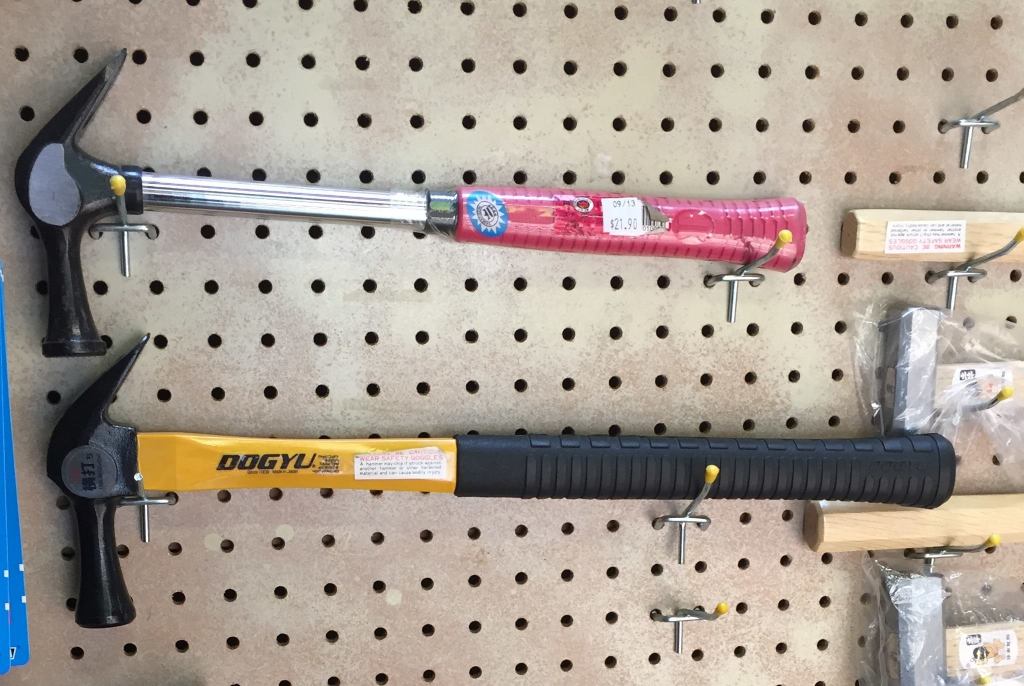

Japanese Style Hammers at Hida Tool Store in Berkeley, California

The defining features of a Japanese carpentry hammer are an elongated “neck” out to the striking face and a short sharp claw. The sharp end digs in like a cat’s paw and the short distance from claw to pivot point provides greater leverage when pulling nails. I can’t tell you why the neck is that way; it could simply be a matter of style. How else to explain the square face and asymmetrical claws on a German hammer, the untapered neck on an English hammer, and what we consider to be a “normal” American hammer? For more on hammers, see Chaz Arthur’s Amazing Collection of Framing Hammers.
