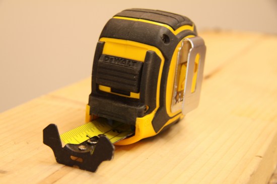

A large wing-style hook is ideally suited for framing tasks, though not for short inside measurements. The tape itself features easy-to-read markings oriented for right-handers. The belt clip is unique in that it doesn't attach with a screw and is always open, making it easy to clip onto pants, belts, and tool bags.

- DeWalt put some time and energy on the first 9” of the tape where they added a heavy-duty thermoplastic coating that not only protects the blade from kinking and breaking, but it also protects the markings from wear.
- It also features an oversized hook which, if you’re framing, is a nice feature. If you’re doing any kind of finish work or take frequent short inside measurements, this isn’t the tape for you because the hook does become a bit of a nuisance in those situations. The larger hook is attached to the blade by 3 rivets and it is stout enough that it will resist bending.

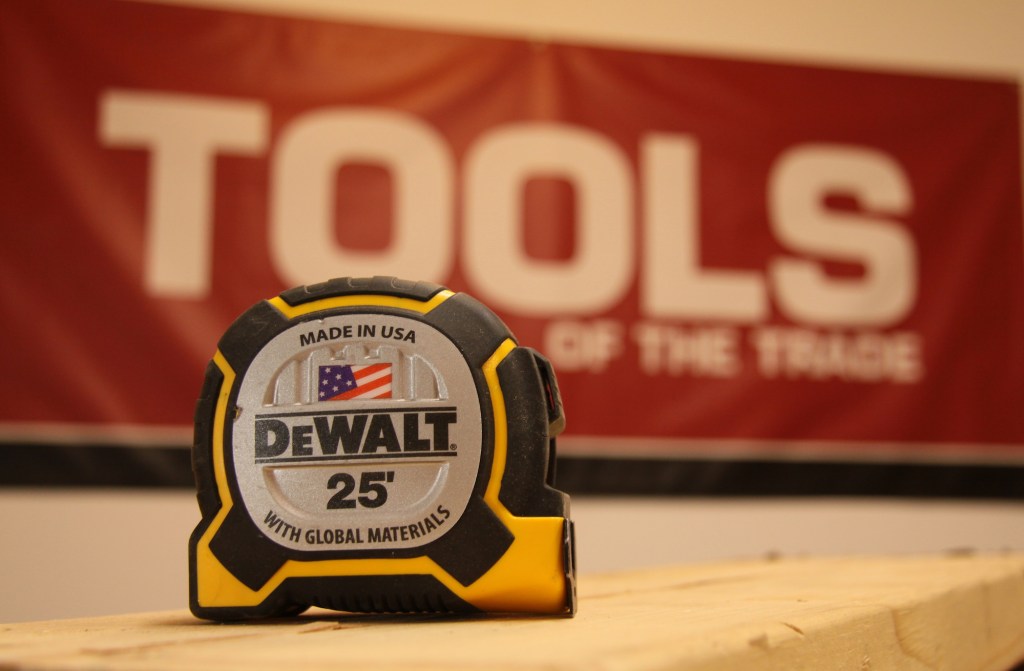

- The blade is housed in a PC/ABS and rubber case that DeWalt boasts can withstand a 60’ drop (onto compacted soil). Rob Robillard of Tool Box Buzz drop test the tape from 30’ onto asphalt and it barely endured a scratch.

- The 25’ tape that I’ve been using isn’t lightweight though it’s well-balanced and comfortable in the hand. The tapes have a built-in lanyard connection as well. If you’re a framer or otherwise in need of a heavy-duty tape in either 25’ ($30) or 35’ ($40) configurations, the XP is worth considering.
