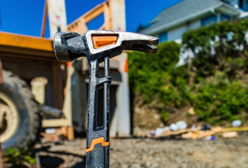

Framing Hammers
First off I have to say that I love the grip on these tools, which is very comfortable and slightly soft. I feel like I get a really good grip, even in the rain. The IsoCore does dampen vibration compared to a wood handled hammer, but I did still feel some vibration. Compared with the TiBone I normally use that has virtually no vibration, I noticed a difference.
The new hammers from Fiskars feature a handle design that is comfortable in the hand, and a magnetic nail holder.
