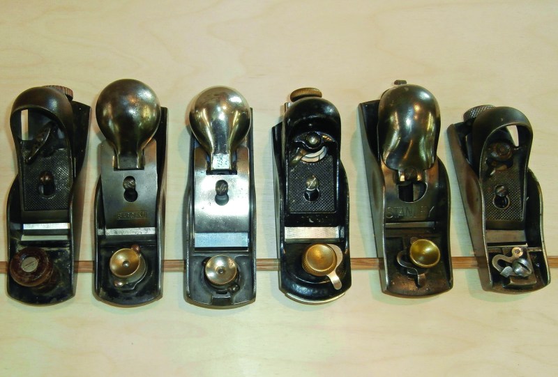

Acquiring block planes. I have a number of block planes that I purchased at a large antique market held three times a year in Brimfield, Mass. I have never paid more than $25 for one. I recently checked E-Bay; at this moment there are more than 100 block planes of similar quality to mine for $25 to $50.

Two types. A standard block plane (like a Stanley 9-1/2) has a 1 5/8-inch-wide iron and a bedding angle of about 20 degrees. (Note that the bedding angle—not to be confused with the bevel angle of the iron—is the angle at which the iron sits in the carriage of the plane.) A low-angle block plane (like the Stanley 60-1/2) has a bedding angle of around 12 or 13 degrees and a narrower, 1 3/8-inch-wide iron. I prefer the low-angle version for trimming end grain and for how it fits my hand. The best models have an adjustable throat plate, which helps as a chip breaker to control the depth of cut.

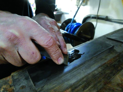

Start by flattening the back of the iron on a whetstone. I use an oil stone, but water or diamond stones are just as good. On a flat stone, it’s easy to tell when the back of the plane iron is flat, because the polish from the stone will be uniform.

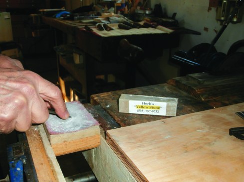

The last step is stropping on a piece of leather (rough side up) tacked to a block and loaded with Herb’s Yellow Stone compound.
Next, hone the cutting edge. While larger bench planes have a super-shallow arch profile across their cutting edge, block planes are ground straight across with a tiny slope at each corner of the iron. Take the new edge to your whetstone. Remove the burr from the flat side of the iron. Flip to the other side, find the bevel angle, and then raise the iron slightly. When you begin honing, this slight raise will create a 4-degree micro-bevel. This is your actual cutting edge. Some people hone in a straight line; others use a figure-eight pattern. I use both. At this point, you are only trying to remove micro nicks in the edge.
The last step requires a leather strop. You can buy one or make one by gluing a piece of leather—rough side up—to a hardwood block. I load the leather with a fine coating of Herb’s Yellow Stone compound (available on Amazon for $10). With the compound, the strop will give an old-school barber’s edge.
