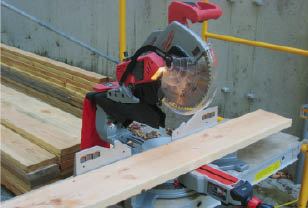

At 65 pounds, the Milwaukee 6955-20 is a big miter saw — but big material calls for a big saw. Like most saws in its class, moving it requires two hands.
Though the 6955-20 is weighty, it’s not unwieldy. In fact, it’s surprising how smoothly the saw operates. Its head rolls like a dream on slide rails, and its soft start reduces the initial jolt of the 15-amp motor.
The saw has a couple of features to help with precision. A 1/10-degree miter-angle fine adjustment makes it easy to change a miter angle just slightly and then accurately repeat it. And although it’s a simple idea, my favorite feature might be the two lights, one mounted on each side of the blade. I’ve always thought carpenters deserved to see their cut lines, especially when existing light is bad.
When it comes to actually cutting through wood, this saw is a winner. Right out of the box, the 90-degree crosscut needed no adjustment. It has all the usual detent settings and can easily crosscut 2x12s and 1-by up to 14 inches and can miter a 2×10. The 12-inch blade will cut nearly 5 inches deep across most of the crosscutting range of the saw.
Because the motor is placed above and behind the blade, the saw can cut full 2-inch stock 6 1/2 inches tall. I’m not sure when a deck builder would need this capacity, though, unless for an occasional inside job working with big base molding.
The saw’s bevel adjustment is in the rear, which at first seemed like it might be less convenient than having it in the front, as some competing saws do. However, the large, flat lever handle was easy to engage and disengage, and the rear bevel adjustment proved to be no inconvenience at all. The beefy 3/8-inch-thick steel depth stop is reassuring for a saw this size and flips out of the way for intermittent use. Its thumbscrew adjustment feels secure and comfortable.
Worth noting is dust collection that actually collects sawdust — not everything but most of it — which is a big improvement over saws I’ve used in the past.
I don’t have much to nitpick about. The blade guard whacked my thumb a few times as I lowered the blade until I learned to keep out of its way. And the manufacturer-supplied, 60-tooth, ATB blade was nothing to brag about, though it was fine for framing material. But all in all, the Milwaukee 6955-20 is a great new saw.
