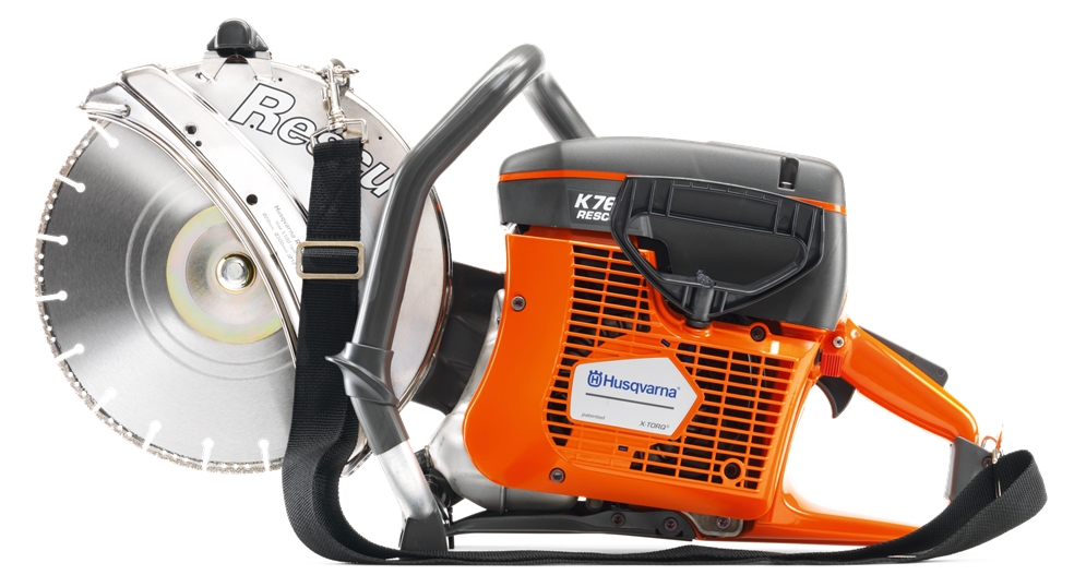

First responders referred to a gas powered rescue saw. The Husqvarna model K760 is one of many available models.

Last week two men working in the basement of a house in Evanston, Illinois were rescued by paramedics and taken to the hospital after being sickened by carbon monoxide fumes from the gas-powered cut saw they were using. First responders referred to the tool generically as a “K-12 saw”, a rescue saw made by Husqvarna and used by many fire departments. The men were probably cutting through a concrete slab with some other brand/model of cut saw—since construction workers are unlikely to use a rescue saw.
