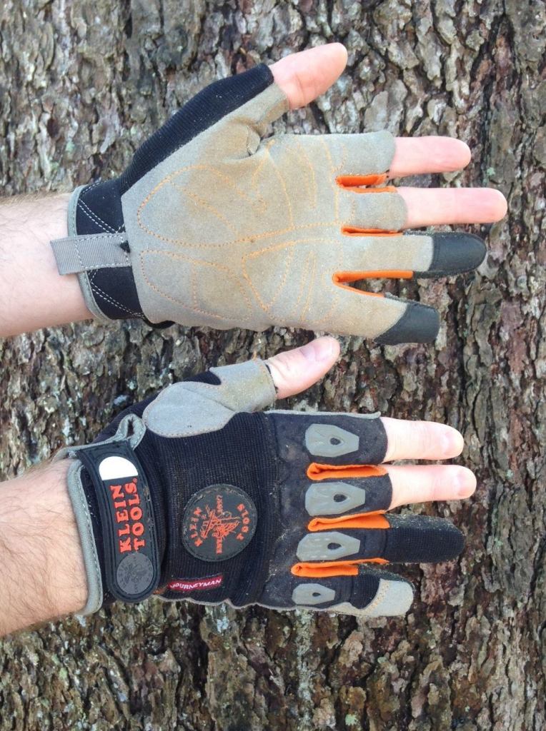

For most job site carpentry work, I like the Klein K2 Journeyman Framer gloves which leave the thumb and first two fingers exposed. I used to wear full coverage work gloves, but there were just too many times when I needed the precision of my fingertips, whether it was marking up a set of plans or fishing keys out of my pocket. Plus, with no fingertips, I can use a touch screen without having to take my gloves off. The exposed skin does risk the occasional splinter, but to me the trade-off is worth it.
The Kleins are nice and basic, which is how I like my gloves. There is some minimal padding on the back near the knuckles, but not enough to be considered too bulky or too flashy. The sides of the fingers are Lycra, so there is nice tight fit, but still good flex and movement. I also really like how the two gloved fingers have a ‘tackier’ material at the tips. This helps with traction while feeding lumber through a table saw. And even though I’m generally wary of hook and loop wrist straps, the ones on the Kleins have a tenacious grab that holds secure.
When it comes to these gloves, I can’t find anything to complain about.
Klein K2 Journeyman Gloves
Price: $27
