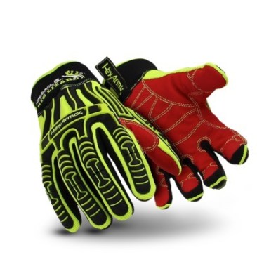

HexArmor Rig Lizard 2021 I decided to try a heavier-duty glove too, which isn’t necessarily ideal for daily use. But when we are moving materials, dealing with demolition, or doing foundation work, gloves like these are worth wearing. The Rig Lizard has an oil-resistant synthetic palm, impact exoskeleton with smash guards, double-stitched exterior seams, and a hi-vis color scheme.

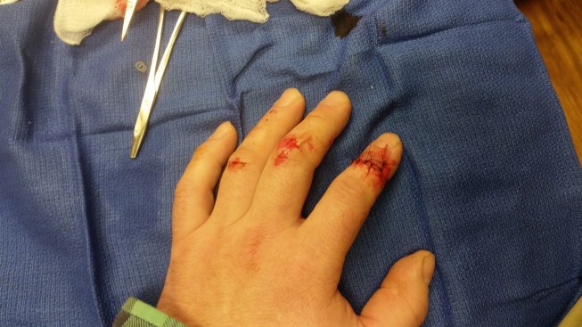

Additionally, I should have been wearing them when I was moving rebar recently; the fork on the forklift swung back and sliced my index finger enough that I needed seven stitches. Had I been wearing this glove, I wouldn’t have had any injury at all. Had the fork been one inch closer, I would have lost three fingers from the middle knuckle up.
After using this glove, I feel it is worth owning a pair and using them for heavier-duty activities. They look like goalie gloves in soccer but are very comfortable. At $35 a pair, they might sound steep until you consider that they are cheaper than stitches.
