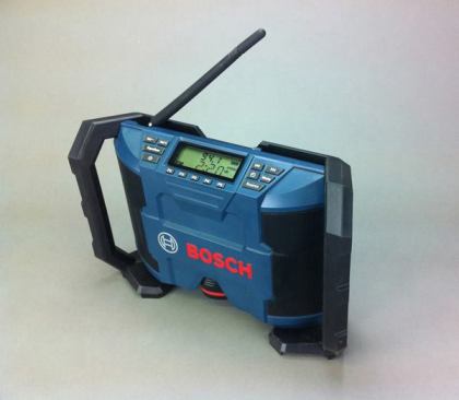

This spring Bosch released a pair of radios that are a fraction of the size of their Power Box.
The 12-volt model (PB120) was announced in March and the 18-volt model (PB180) in May. I have only seen the 18-volt model (more on it in a future entry) but have been using the 12-volt model for about six weeks now.

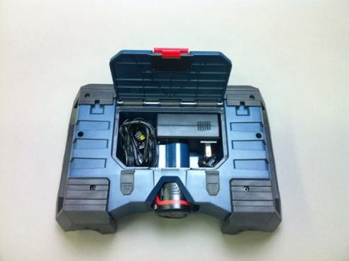

The PB120 contains a pair of speakers, an AM/FM receiver with a scan function, and a 3.5 mm auxiliary input for a media player or phone. It has an LCD screen, equalizer (bass/treble), mute button, and five buttons for preset stations. The device can be powered by an AC adaptor (included) or the same three-cell lithium ion batteries (not included) used in Bosch's subcompact power tools. The AC adaptor stores in a compartment on the back of the housing – which is quite convenient because it makes it less likely you'll lose or misplace the adaptor. The auxiliary connector cord fits in there too.
This is a good radio for use in the shop or on a small jobsite - where you are not planning on blasting tunes so people can hear them 100 feet away. That's not to say the radio lacks volume; it puts out the amount of sound you'd expect from an audio device of its size (approx. 12 x 8 x 3 inches). The radio reception is fine, though I rarely made use of the tuner – preferring instead plug my phone into the auxiliary jack and listen to podcasts or streamed music. The radio has one annoying feature; it does not retain the volume setting. When you power it up it automatically goes to about half-volume. I'd rather it came on at the setting it had when I turned it off.
