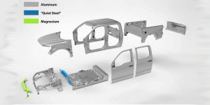

Nearly all of the body parts of the new F-150 are made from aluminum alloy, joined with structural adhesives and specially coated self-piercing rivets. In a steel body truck the connections are made with spot welds.
