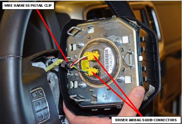

One of several photos in the service procedures issued to dealers for recall R36, this shows the backside of the airbag component.

Recall R36 applies to certain 2012-2014 Ram trucks equipped with the Electronic Vehicle Information Center option. The steering wheel wiring harness in affected vehicles may rub against the driver air bag module retainer spring—which can lead to an electrical short that causes the driver’s side air bag to deploy unexpectedly. The recall applies to approximately 1 million Ram 1500, 2500, 3500, 4500, and 5500 trucks and is separate from the airbag-related recall issued in May of this year for approximately 4 million 2005-2011 Chrysler vehicles (including certain Ram and Dakota models). The company will notify owners, and dealers will inspect, repair as necessary, and secure the steering wheel wiring harness. Additionally, protective caps will be added to the air bag retainer spring ends. The recall is expected to begin September 19, 2015. Owners may contact Chrysler customer service at 1-800-853-1403.
