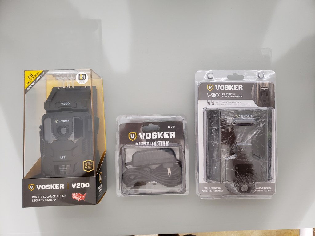

For starters, the security camera came in great, easy-open packaging. It’s a minor thing but being able to easily open a package without a razor knife and dynamite are important to me. [Editor’s Note: Howling!]

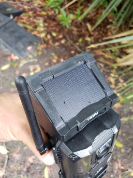

The V200 has a solar panel and eight AA batteries to keep it permanently powered up.

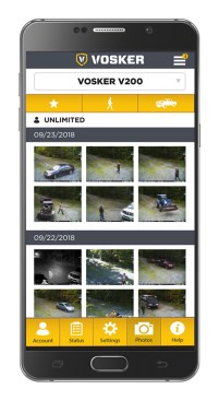

The unit came complete with everything I needed (V200 LTE camera w/solar panel, steel security box, 12-volt adapter, tree strap, and SD card for video) and was simple to power up and connect. I downloaded and installed the app on my Samsung Note 9 without any issues. You do need a monthly subscription to view the pictures on the Vosker app/web portal. There is a basic free option and there are three other, affordable options to choose from depending on how you plan to use your 4G/LTE Vosker V200.
The onboard user interface (as well as the app and website) are easy to navigate. It was up and running in a matter of minutes. The camera itself has an internal battery that is kept charged by the solar panel. It also has eight AA batteries to aid during extended periods of low light.

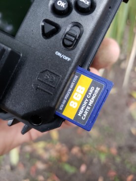

The unit comes with an 8-gig SD card—awesome detail; I don’t have to find or go buy one—and I can view or save items on my computer.

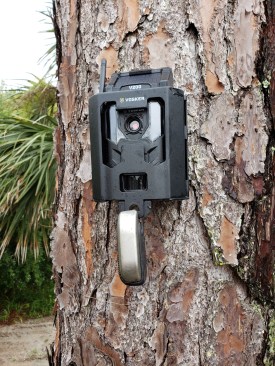

In addition to security, one application I tested it for was monitoring one of my remote jobsites. Mounted securely in the steel housing, the camera faces the front of the jobsite. This does a few things. Aside from the basic security against theft, I know as soon as my guys pull up on the job. Handy information. And from a business and marketing standpoint, I sent the web portal login to my client, who lives out of town. He’s able to log in and see the progress.
The steel security cage is rugged. This is where a bad guy would need some C4.

The Vosker app has a free version and three affordable subscription versions. The whole set-up isn't free, but like the commercial says: What’s in your trailer? (And do you want it back if somebody takes it?)
