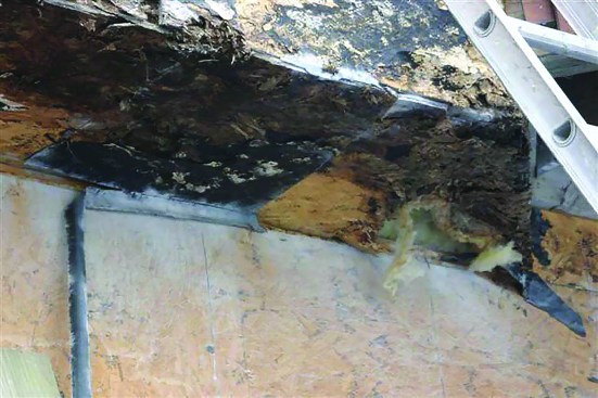

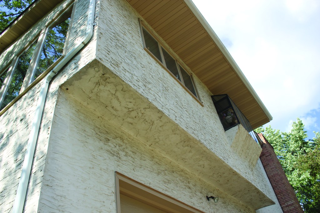

A stucco bucket is an overhang where the stucco wraps from the vertical wall to the horizontal surface underneath, without anywhere for liquid water to drain out.
Like a bucket, stucco-wrapped soffits hold water and let your wall components marinate until the lawyers say you need to do something. These problems aren’t limited to stucco, which has been dragged through the mud more than its fair share for poor detailing and execution. Thin-brick, adhered-stone, and even fiber-cement-siding walls suffer the same fate from the wrapped detail. Any time the drainage plane is interrupted, we need a plan for the moisture to exit.
A “stucco bucket” on this stuccoed cantilever resulted in the wall kicking the bucket, so to speak. Water had nowhere to drain and eventually overwhelmed the WRB, rotting the framing beneath.

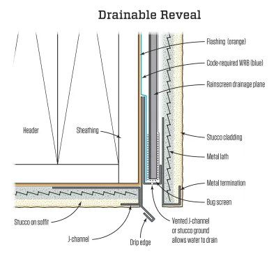

One solution that works on cantilevered areas is to build a drainable reveal.

To misquote an old children’s song, “Put a hole in the bucket, dear Henry, dear Henry.” The most straightforward approach to avoiding stucco buckets is to include a reveal that drains and ventilates the rainscreen air gap (see Drainable Reveal, above). Just let the water out. Where do we need these reveals? Wherever the water control layer changes plane, whether it’s a full 90-degree corner or a smaller angle.
To identify those changes of plane, use the pen test, which is a simple and important process for verifying control-layer continuity on building plans. Use different color pens to trace the water, air, and thermal (insulation) control layers on the wall section details. If you need to pick up the pen at any point, there is a discontinuity with the control layer.
In terms of drainage, any time your pen turns while tracing the water control layer, you need to flash or drain. Flash and slope when the pen turns outward; let the wall drain to the exterior when the pen turns inward.

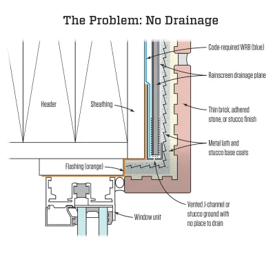

This is the problem: A drainable assembly has nowhere to drain.
Tim Healey

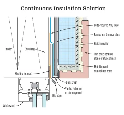

When you are using continuous exterior insulation with thin brick, the insulation can kick the assembly outwards far enough to create a drain reveal with thin-brick corner pieces.
Tim Healey

One common place this is often required is with “innie,” or recessed, windows. These are currently popular with many designers, but creating a drainage reveal over every opening is not compatible with thin stone and thin brick. This cladding uses corner pieces at the header to deceive the eye into believing the wall has a full-wythe veneer. Using a drainage reveal, in this case, would preclude the use of the corner pieces and reveal the thin veneer’s secrets.
One solution is to borrow an idea from the EIFS folks: Use rigid foam to create the inset aesthetic with the drainage plane between the foam and the sheathing (see illustrations, right). This resembles an inset window in an EIFS wall—just limit the air gap to 1/8-inch drainage gap to maintain 95% of the insulation’s R-value.
