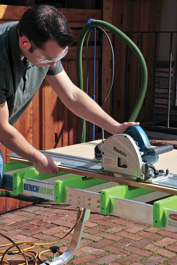

Having positioned the stock with the cut line over the recessed part of the crossbars, the author rips it without fear of cutting into the surface below. The recesses can also be used as stops when cross-cutting narrow material with a hand-held saw.

The Benchmark differs from the tables I’ve used before (usually a door blank on sawhorses) in a couple of important ways: It folds, so it’s easier to transport; and it has an open top consisting of a series of cross bars covered with stepped plastic caps. Since the top isn’t solid, you can cut on it with a circular saw without damaging the work surface — you just position the piece so that the blade passes between the cross bars or through the channels where the caps step down. If you misjudge and hit a cap, you’ll only be hitting plastic.
The open top allows you to clamp in ways that wouldn’t be possible with a solid top, and to fasten from below when you want to avoid flipping the material. The caps are made from nonmarring ABS plastic and are brightly colored so they’re easy to see.

I do a lot of pocket-screw joinery, and I find the open top helpful because I can support the material and still clamp the joint over the table. With a solid-topped table, I’d have to block the material up or hang it off the end. The bench is also great for breaking down sheet goods. We use it with a track saw, though it should work just as well with a standard circular saw. There are photos on the manufacturer’s website that show the Benchmark being used with a miter saw. Personally, I would never buy it for that purpose because there are plenty of miter-saw stands that cost less and are even more portable than this bench.
