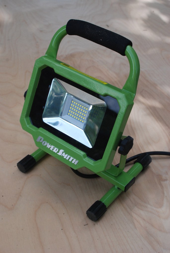

As a remodeler, I’m constantly working in dark places: attics, crawl spaces, and just about anywhere in winter when work starts before sunrise. I can get usually get by with a work light and a flashlight, because the area lighting is already there or has been taken care of by the electricians. Here are a couple of lights I’ve been using lately.
Powersmith 2000 Lumen Work Light
For task lighting in a poorly lit corner of a room, I’ve been testing out the new Powersmith 20 Watt, 2000 lumen LED work light. It looks just like a traditional halogen light but because it’s an LED, it doesn’t have any of halogen’s downsides like scorching heat or fragile bulbs. It’s advertised as having 2000 lumens, which, according to the manufacturer, is comparable to a 100-Watt bulb. My old halogens are brighter, but I’ve found the Powersmith emits more than enough light for me to work.
The Powersmith comes on a little stand and has all of the same up/down, side-to-side pivots of a halogen, all controlled with tightening knobs. It comes with a 5-foot cord attached, which is about two feet shorter than I’d prefer. But I usually have an extension around, so that’s hardly a problem.
The one downside to the Powersmith is the price. At $40, it’s more than twice the cost of a brighter halogen that can be purchased for about $15 at the local box store. Personally, I’m fine paying the additional cost. Just knowing that I’ll never have to change a bulb or smell a burning moth makes it worthwhile for me.
The light I tested is a new model that’s about to come out. But Powersmith makes others that put out more or less light than the model in this story.
