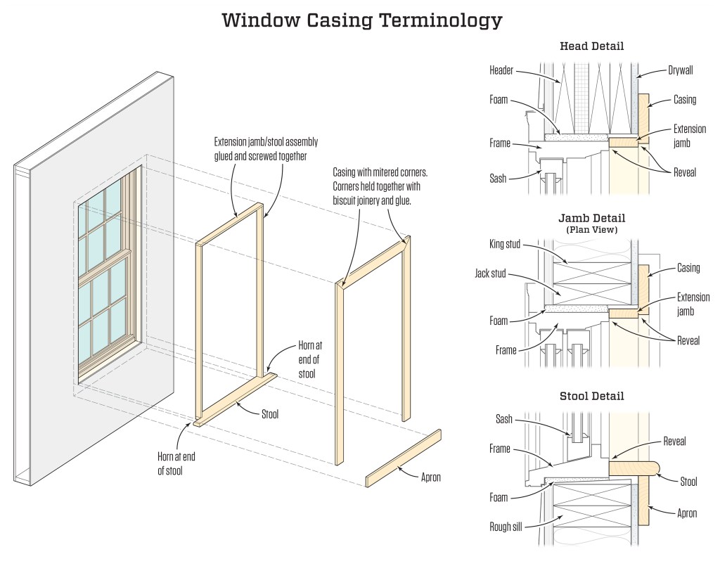

The trim around a window, known as casing, makes the physical and visual transition between the window frame, or jamb, and the surrounding wall area. Stylistically, casing may take any one of dozens of forms, ranging from Colonial to Craftsman to Greek revival to Modern and everywhere between, with variations limited only by the imagination. But regardless of the style, the approach to casing the window is similar.
There are two basic ways of casing windows: the “picture-frame” method, in which the casing detail is the same on all four sides of the window, and the more traditional style with a stool (commonly called a windowsill) and apron. In this article, we’ll focus on the traditional approach. However, because the top of the casing gets mitered, we’ll touch on the important aspects of the picture-framing method, as well.

Vocabulary:
Extension jamb: Lengths of wood that build out a window frame flush with the interior wall surface.
Casing: Material that finishes the joint between the extension jambs and the interior walls.
Stool: The horizontal finish material extending from the lower part of the window frame that is a termination point for the casing and the extension jambs.
Apron: Horizontal finish material below the stool.
Reveal: Small offset between layers of material that creates a visual step or line in the finish.
Miter: An angled cut across the flat part of a profile that usually forms a 90° joint.
Bevel: An angled cut perpendicular to the profile that usually forms a 90° joint as the return.
Return: A small triangular piece of a profile that completes a profile back to the wall.
Biscuit joinery: A method for joining two pieces of wood using a slot and pre-formed oval biscuit.
