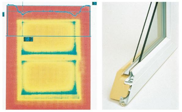

Conduction is the movement of heat energy directly through solid materials from molecule to molecule. The movement of the material plays no role in the transfer of heat.
Building materials conduct energy at different rates. Metals, such as copper and steel, for example, have high conductivity, meaning heat energy moves through them at a very efficient rate. Fiberglass batts and rigid foam, on the other hand, have low conductivity. Materials that are poor conductors serve as insulators when they are placed between more-conductive materials in an assembly such as a wall or a roof. The flow of heat through an assembly of materials is slowed down appreciably by insulating materials. Wood is somewhere in the middle for conductivity. It’s not a good insulator unless it is shredded and has lots of air pockets between the wood fibers. (The secret behind most insulation is air pockets that disrupt the conductive heat flow through a material.)
The rate of conductive heat flow is measured as U-value, and resistance to heat flow is measured by its reciprocal, R-value.

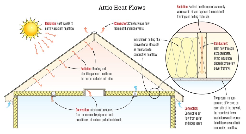

Convection is the flow of heat within a fluid, with warmer fluids rising and colder fluids falling. In homes, this fluid is air; in the ocean or a boiler, it’s water.
In air, convection is often called the “stack effect.” As air warms, the molecules move farther apart, and the air becomes more buoyant, floating upwards. As that air rises, cold air is pulled from below to replace it (for more, see “Air Barrier Basics,” Jan/19). In a boiler or heat pump, warmed water circulates in a similar way, and piping systems can be designed to use this “thermosiphon” to circulate water.

Radiation is the movement of heat through space (not air) as electromagnetic waves. The sun’s energy reaches earth by radiation. Radiation is not affected by the air. The sun and a campfire both emit radiant heat, even when the wind is blowing. Radiant heat moves at the speed of light without heating the space between the radiant source (often called a “radiant body,” be it the sun, or a heated slab, or a mass of asphalt roofing, underlayment and wood sheathing) and the surface of another object.
When an object, or an assembly is warmed by radiant energy, the energy is absorbed into the material. To be warmed by a radiant heat source, the surface needs to be in the line of sight of the heat source. This is why shading works. We can put an overhang or an awning between the sun and a window to reduce radiant heat flow. In that case, the sun warms the overhang or the awning when the energy is absorbed into those materials.
