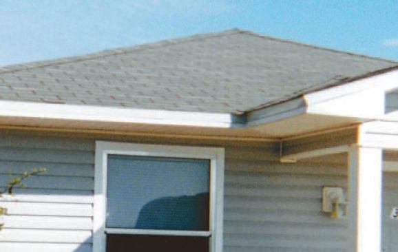

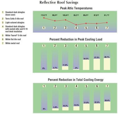

It’s well established that reflective roofing materials can lighten the load on home air conditioners. When researchers at the Florida Solar Energy Center (FSEC), where I am a principal scientist, whitened the roofs of nine occupied homes in the summer of 1994, air-conditioning savings averaged 19%. We got even better information by comparing seven otherwise identical new homes with various roof types in a study sponsored by Florida Power & Light (FPL) during the summer of 2000. All these homes had R-19 ceiling insulation, but each had a different roof covering. Clearly, reflective roofing made a huge difference.
One house of the seven had an insulated roof deck, to keep the ductwork within the sealed, conditioned attic. That modification did save energy on average, but not as much as the reflective roofs — and it had little effect on peak loads.

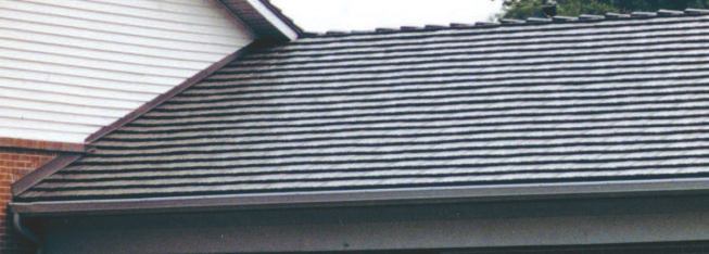

Cool colors. Until recently, a roof had to be white to have high solar reflectance — something not every customer wants. But we now have tile and metal roofing systems made with “spectrally selective” paints, which absorb some colors of light in the visible range but reflect rays in the infrared and ultraviolet spectra that account for much of the sun’s heat. These colors give designers more choices, while still saving considerable energy.
BASF Corporation’s ULTRA-Cool metal-roof coatings www.basf.com), which use spectrally selective pigments from Ferro Corporation ( www.ferro.com), have a 38% reflectivity in colors that achieve only 25% reflectivity when made with standard pigments. And at least two companies, Classic Products ( www.classicroof.com) and MCA Tile (www.mca-tile.com) now supply metal or clay tile in a range of colors with solar reflectance around 30%. Classic’s “Musket Brown,” for instance, reflects 31% — quite a bit better than a white shingle — while the same color in traditional paint would reflect only 8%.

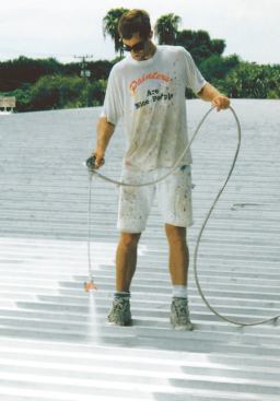

Bare metal roofs. Unfinished galvanized or “tin” roofs are still fairly common in the hot Southeast. Galvanized steel is highly reflective when new, but its reflectivity soon drops as the zinc oxidizes; and the material also has low infrared emittance. The high absorptance and low emittance can combine to keep the roof blazing hot.
When FSEC researchers put a white coating on the ten-year-old galvanized steel roof of a retail strip mall, the roof’s reflectance went from 30% to 77%. The average air-conditioning reduction in seven monitored shops was more than 24%.
If you want unfinished metal roofing, Galvalume (an alloy of aluminum and zinc) is a much better cool-roof choice than galvanized steel, especially in mixed heating and cooling climates. Galvalume maintains its reflectance as it ages, and its low emissivity means it holds heat well in winter even though it reflects well in summer.

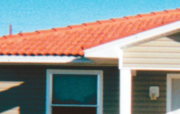

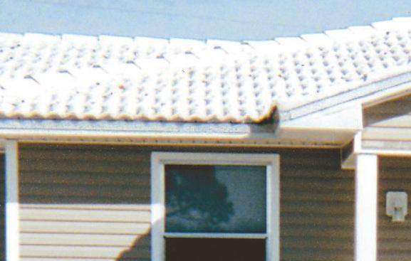

It’s conventional wisdom that tile roofs are cooler than shingle roofs. To a small extent, that’s true: S-tiles permit cooling airflow between the tile and the roof deck, and their thermal mass stores energy during the day and re-radiates it at night, instead of passing it all through to the attic.
But the color of the tile matters. For instance, we painted some dark gray tiles bright white at midsummer in central Florida in 1996, and we measured an 18% drop in space-cooling energy.
Shape appears to be far less important than color. In the seven-home side-by-side study for Florida Power & Light, one of the homes had flat white tile, and another had white S-tile. We didn’t see much difference — both roofs did about 20% better than the asphalt shingle roof. An S-shaped red tile roof in the same study was only 3% better than dark asphalt shingles.
In general, light-colored metal roofs will outperform tile in a hot climate like Florida’s. At night, they actually radiate attic heat upward into the night sky, cooling the attic to below the ambient air temperature. The thermal mass of tile will not let attic heat escape so readily.

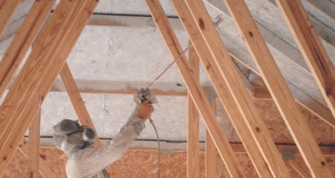

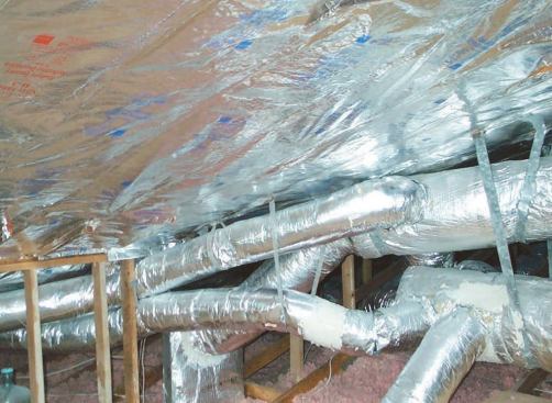

The basic radiant barrier is a layer of aluminum foil placed with its shiny side facing a clear air space. Placed under the rafters, aluminum’s low emissivity prevents heat from radiating off the shiny surface onto the insulation below. If the surface gets dirty, it won’t work as well; that’s why radiant barriers placed shiny side down, so dust can’t collect, work better than radiant reflective material placed facing up.
There’s now a range of material choices for attic radiant barriers, including radiant-barrier sheathing, spray-applied low-emissivity coatings, and a wide variety of foil products. Homes with complex attic geometry and poor access to the space are not great candidates for a foil application, but a radiant barrier sheathing is easy to apply to any new house, and a spray-applied low-e coating such as Lo/Mit from Solec, Inc. (www.solec.org) makes a practical retrofit.
Energy savings. Radiant barriers are effective. Our research indicates that under-roof foil barriers reduce heat flow through the ceiling by 30% to 50% and can bring annual cooling electricity savings of 7% to 10% in the Southeast climate.
Radiant barriers also have a strong effect on peak loads for the air conditioner. A nine-home retrofit study we conducted for Florida Power Corporation found that radiant barriers reduced air-conditioning power use by 9% and cut afternoon air-conditioning peak loads by 16%. In a six-ton system, that’s a ton of cooling. Attic temperature peaks dropped by about 8°F. Perhaps most important, indoor temperatures fell by an average 2°F — a boost for homeowner comfort.

And be aware that if you have a reflective roof to begin with, a radiant barrier is overkill — and may even be counterproductive. Since the underside of a reflective roof does not get hot, a radiant barrier under the roof adds little benefit. On the other hand, by reflecting heat inward, the radiant barrier will impede the ability of the attic to radiate excess heat to the night sky.
Another word of caution: We installed our test radiant barriers in midsummer, so we could immediately measure the benefit. But the attics we worked in were dangerously hot — one of our people actually had to stop and get medical attention. It’s much safer to install attic radiant barriers in the cool season, or at least during the early morning before the attic is baking hot.

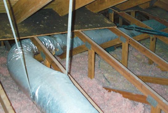

Added insulation is another option for cutting heat gain through the roof. It certainly works: One of our studies for a Florida utility showed that boosting ceiling insulation from R-19 to R-30 cut space cooling by about 9% in summer.
But your mileage may vary. Duct systems in many homes run through the hot attic and may be insulated to only R-4 or R-6. So the air conditioner is sending 55°F air into the duct in a space that can reach 130°F on a hot day. That’s a temperature difference of 75°F, across just an R-6 insulated duct wall — much greater than the 20°F difference you might see from indoors to outdoors across an R-11 or R-19 building wall. And duct surface area is much greater than you might think — often as much as 25% of the house floor area. During the hottest hours, as much as 30% of the cooling system’s capacity can be lost to heat gains in the duct system. Besides the wasted energy, this means it takes longer to cool down the house when the air conditioner kicks in.
Unlike a reflective roof or attic radiant barrier, ceiling insulation does little to address duct system losses. So if your design relies on ceiling insulation to limit roof-related cooling loads, try to locate the duct system within the thermal envelope, below the insulated ceiling. Even running the ducts through the crawlspace, though they might be exposed to outdoor air temperatures, will add less to the load than running them through the solar-heated attic.

In our seven-home side-by-side comparison, the house with a sealed and insulated attic used 9% less energy than the base case house, even though both had dark shingles. Some of us were expecting a greater savings, but several factors limit the benefit of this method.
The big advantage is that the ductwork is inside the thermal envelope. However, while a ventilated attic can flush some heat out through the vents, an insulated roof deck fights its whole battle at the roof surface. Also, the air conditioner has to treat the additional air volume of the attic space.
Beyond that, an insulated roof deck contributes more heat to the house than an insulated attic floor does. Heat transfer is proportional to the temperature difference, and also to the area of the surface. In a ventilated attic on a hot day, the top surface of the ceiling insulation may hit 130°F — a 55°F difference with the 75°F interior. But the deck of an insulated roof in the direct sun may reach 170°F while the attic reaches 85°F, for a difference of 85°F across the insulation. That wider temperature gap drives faster heat gain. And that faster gain is multiplied by a greater area, since the roof area is anywhere from 5% to 40% greater than the ceiling area, depending on the pitch of the roof (not to mention the gable ends).
So with an insulated roof deck and a sealed attic, it is very worthwhile to block that solar gain right off the bat: Use a lighter tile, white shingles, or a more reflective metal. In our study, the sealed system with dark shingles did about 9% better than a ventilated attic with dark shingles. With a reflective roof, the sealed attic would likely post savings of 25% or 30%. Even matched with white shingles (with a reflectance of 25%), we estimate that the insulated roof would have scored about a 13% savings compared to the dark shingles and vented attic. Also, it’s worth noting that we carefully sealed the ductwork in all the test houses, to avoid confusing the results. If the ducts are leaky, the benefit of a sealed attic is much greater, because those leaks can’t communicate with the outdoors.
