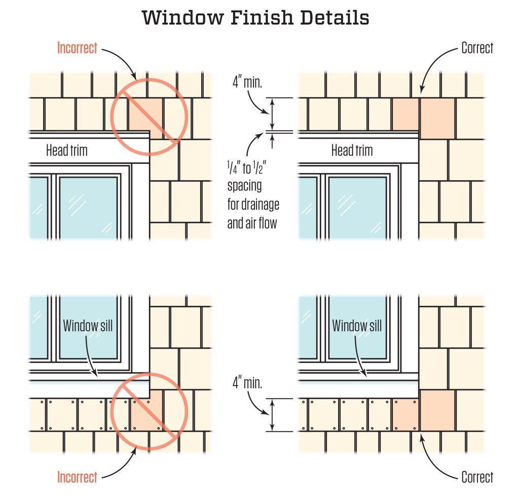

When you’re shingling around windows, exposure should be no less than 4 inches for the courses above and below the windows. Be sure to leave ample clearance between the course above the window and the head flashing. For proper drainage, align the shingle gaps with the corners and avoid having shingles that wrap around the corners.

In addition, measure the distance from the bottom starting edge to the bottom of the windows. Adjust the layout so that you are not left with a narrow strip to fill in under a window. Also measure to the top of the windows and try to make the bottom edge of a course line up with the top of the windows (including a drainage gap over the head flashing). Maibec says that you should not have less than a 4-inch course below or above a window.

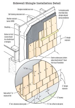

Starter Course
The bottom of the wall starts with a double layer of shingles, so that the angle of the courses is consistent top to bottom. The inside layer is called the “starter course,” and because it will be covered, it can be made with inexpensive, lower-grade shingles.
Overhang. Pay attention to the placement of the starter course. Maibec recommends that the bottom edge of the starter course extend down at least an inch past the top of the foundation. If the wall sheathing laps over the foundation, as it often does in new construction, the starter shingles only need to extend a small distance past the sheathing. The outer first course should then extend 1/2 inch below the bottom edge of the starter course so that water will drip off the outer edge. In addition, note that code requires at least 6 inches between the bottom edge of the first course and grade.

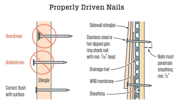

Always drive nails flush to the surface of the shingle. Underdriven nails do not anchor the shingle properly and overdriven nails break the wood. Additionally, always use nails that are the proper length. Remember that nails must go through the layers of shingles, through the drainage plane, and then through the sheathing with a penetration of at least 1/2 inch. Nails for fastening shingles should be either stainless steel or hot-dipped galvanized.

Always establish a drainage plane using drainage mat or furring strips between the shingles and the WRB. Double the bottom course of shingles to maintain the proper angle of that course. The bottom course must be at least 1 inch below the top of the foundation. Let the outer layer of the first course hang 1/4 to 1/2 inch below the inner layer to shed water properly. Drive nails within 1 inch of the exposure line and 3/4 inch from the edges of the shingle. Be sure to leave at least 1 1/2 inches between the gaps on successive courses.

Nailing and Gapping the Shingles
For the next courses, use your story pole to mark out the height of the courses lightly in pencil on the corner boards. Then stretch a chalk line between the corners and snap a guide line. Align the guide strip with the snapped line and tack it in place.
As you place the shingles on the guide strip, take care to offset the gaps between the shingles at least 1 1/2 inches from the gaps in the course below. Leave about 1/8 inch between the shingles to let them expand and contract as they get wet and dry out. Never install the shingles tight to one another.
Nails for attaching cedar shingles should be stainless steel or hot-dipped galvanized and have heads with a minimum 7/32-inch diameter. They also must be long enough to penetrate at least 1/2 inch into the sheathing (see Properly Driven Nails). Place nails 3/4 inch in from each edge and 1 inch above the exposure line for the next course, as shown in the illustration above.
