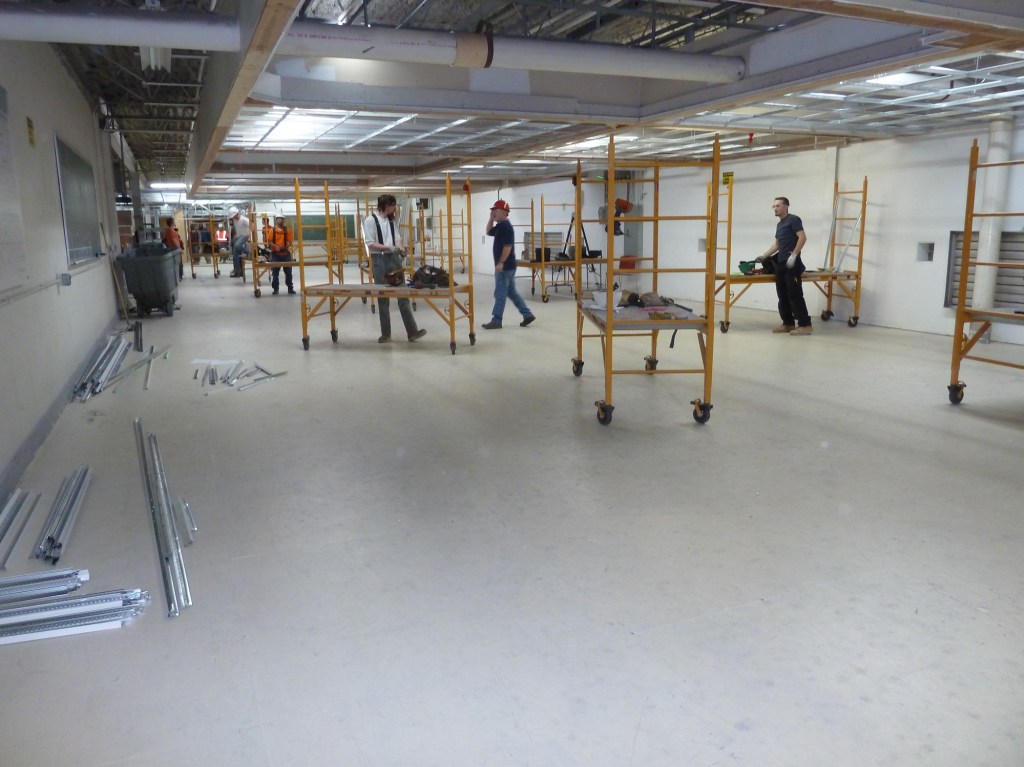

One small part of the Chicago Regional Council of Carpenters training facility in Chicago. The facility offers a wide variety of training programs from cabinet making to concrete form construction.

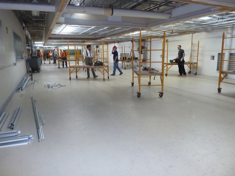

Sue Burnet One small part of the Chicago Regional Council of Carpenters training facility in Chicago. The facility offers a wide variety of training programs from cabinet making to concrete form construction.
