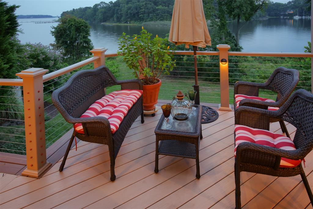

When taking photos of your deck projects, stage it with furnishings and props to help invite viewers to emotionally ‘enter’ the scene.

Props. Instead of taking photos of the deck or outdoor structure immediately after you've finished it, plan to come back on another day when the weather is good. This way, you can dress up the area you are going to photograph.
I like to add furniture, such as a dining set or a coffee table, perhaps a grill, and often some plants to make a space look like it's being used for the purpose that it was originally designed for.
