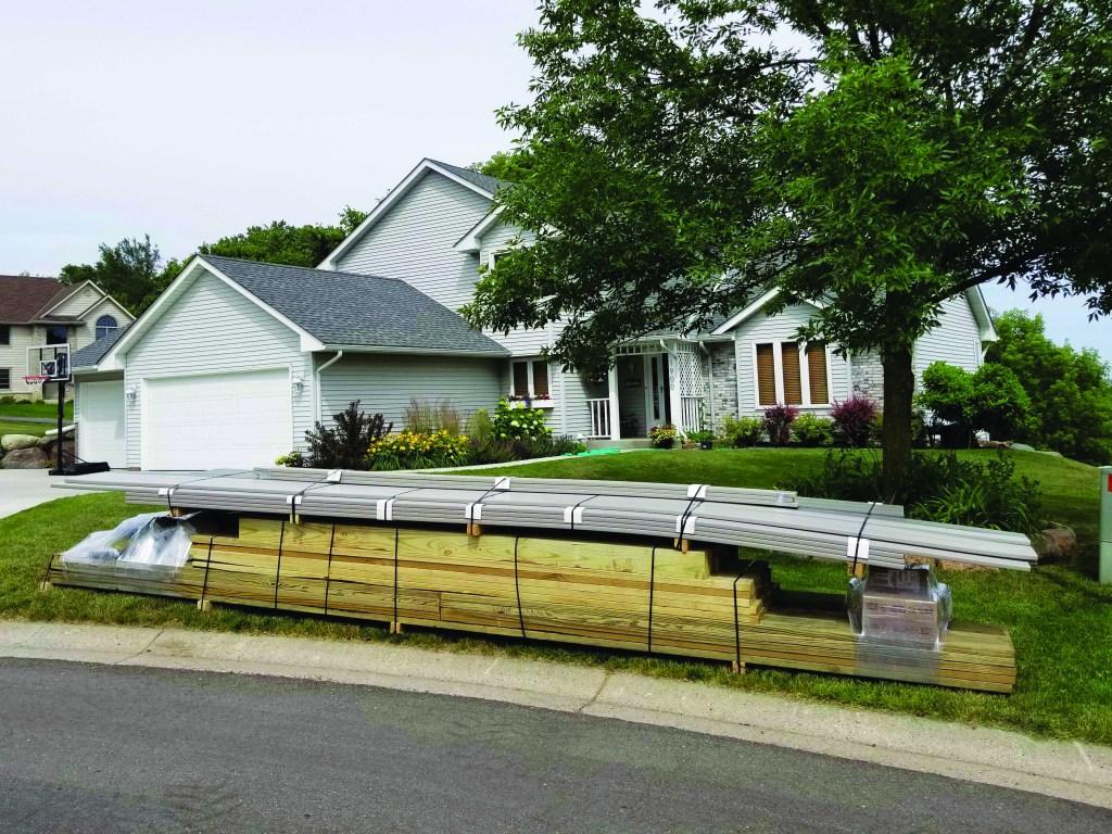

Produced off site, this deck package is ready for assembly. The same production techniques used to prefabricate the parts can be adapted to custom deck construction.

Our company offers a prefabricated deck system that is much more detailed than most would ever care to utilize. But the production principles we use to work more efficiently are applicable to both standard and custom deck builders.
It all started years ago when I bought a notebook to journal every deck I built. I kept track of actual materials used, the actual cut lengths of joists and beams, the leftovers from the order and what was returned to the lumberyard, and the labor hours that it took for each stage of construction. Soon I had a “database” that I could refer to when planning the next deck.
With a little prep time spent with this information the night before, I started showing up on the first day with an actual cut list to give to my guys. By the time I had the ledger installed, they had precut all of the joists and beams and were ready to start framing. While one guy started laying the decking, another was already cutting the rail sections to fit. These methods allowed us to save a little time on each deck, and when scaled over a full season, the increase in productivity was dramatic.
