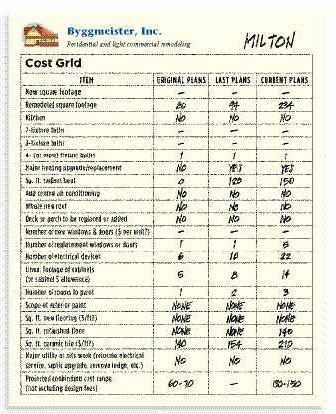

Using a Cost Grid
The format we use is a grid that compares important quantifiable project data in different stages of design development (see examples on pages 2 and 3).
Keep in mind that you can put whatever cost drivers are most useful to you in the first column; you don’t have to use the same categories I use. And your list, like mine, will probably change over time.
The blank rows toward the bottom can be filled in for project-specific items as needed. You can leave the “Projected nonbinding cost range” cells at the bottom blank — or delete them altogether — and still have a useful document. Likewise, you can either spell out the unit-cost assumptions for some items (like cost per square foot of tile or average cost per window) or just look at quantities, depending on what’s most useful.
But keep in mind that it can be helpful to document certain items from early on: An initial assumption of $400 windows that gives way to an ultimate choice of $800 windows can mean a doubling of line-item cost with no apparent scope increase.

The author’s cost grid contains no costs — only important quantifiable line items that drive costs. By tracking the remodeling design process through its iterations, both contractor and customer can monitor cost fluctuations. Comparing “remodeled square footage” with the cost range leaves no doubt about how the clients’ changing program will affect the estimate.
Most important, the cost-tracking grid can help take the apparent mystery out of price increases. Everyone can see the evolution from column to column. And it’s easy and fast to fill in — you don’t have to price anything out or get any quotes. You just fill in the data and take it to the next meeting.

I recently had a project that underwent a significant floor-plan rearrangement in the middle of the design phase. The client’s perception — and mine, too, I have to admit — was that it was just that: a rearrangement. We expected the cost to stay basically the same.
Here, the initial wish list may have proved to be beyond the budget. This is reflected in the lines that show how remodeled square footage increased slightly while new square footage decreased.
But then the architect filled in the grid, and we realized there had been some significant but not-so-obvious scope increases. Because many of the quantities in the current-plans column were 15 percent to 20 percent higher than those in the previous-plans column, I was able to anticipate that the current project would probably cost 15 percent to 20 percent more. Better still, the homeowner was able to anticipate the increase, also — he was right there doing the math with me. He didn’t like it, but he understood and knew he couldn’t argue with the numbers. He was prepared for what would be coming down the road a month or two later, when the revised pricing was complete.
