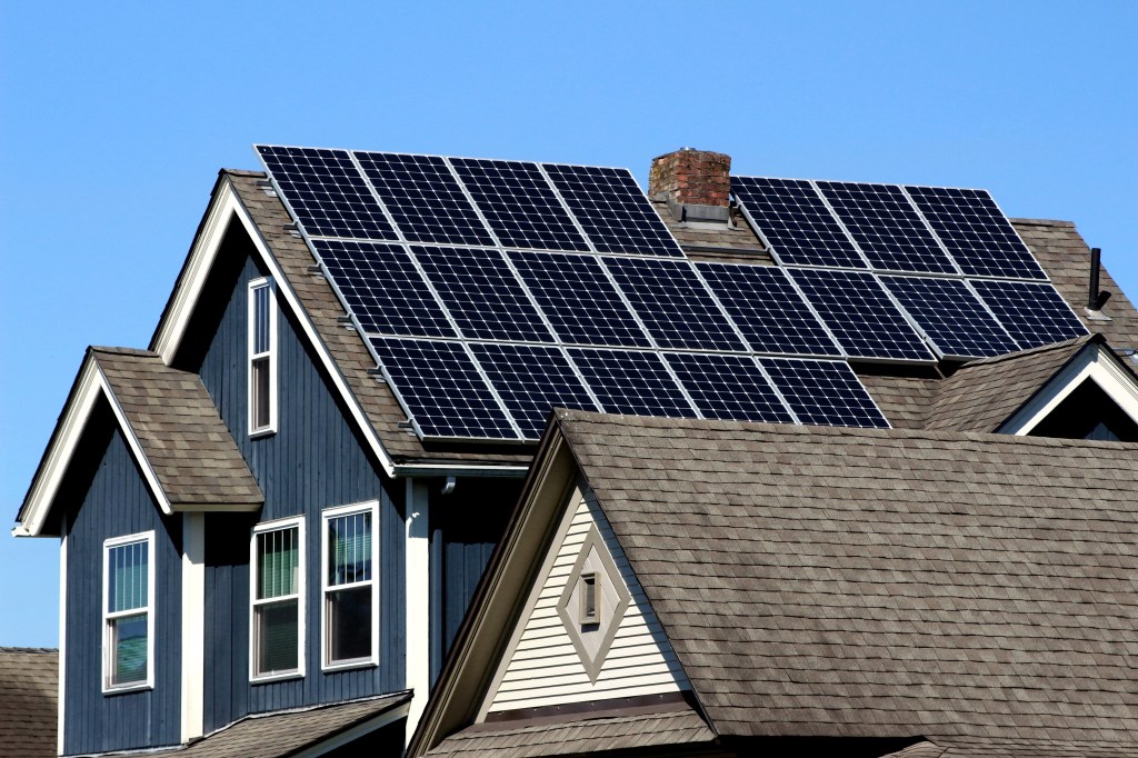

It's been widely reported that California set a new precedent in energy policy this month when the California Energy Commission (CEC) voted to require rooftop solar power arrays on all new homes, starting in 2020. The measure has met intense criticism. But critics seem to be overlooking an important element of the new law.

Criticism centers on an inconvenient truth: During peak solar production times on sunny days, California's grid already has more solar-generated power than it can readily use. On the other hand, during peak afternoon and early evening hours when electric demand is high, solar power production drops sharply, leaving utilities scrambling to make up the difference.
