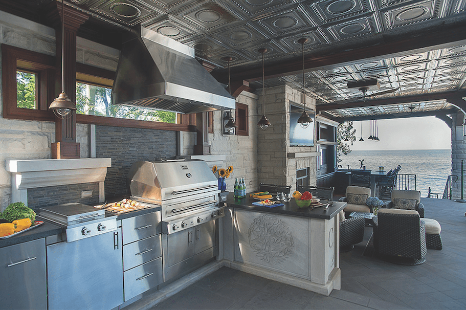

This outdoor cooking area on Chicago's North Shore centers on a combination gas-wood-charcoal grill.

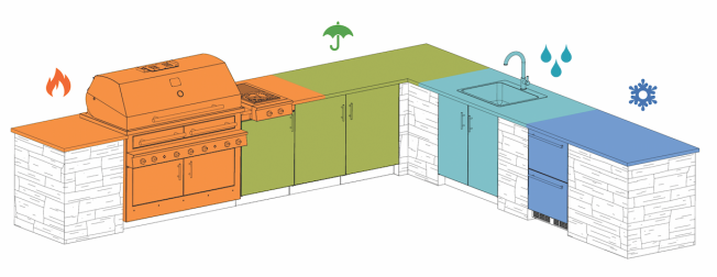

The perfect outdoor kitchen for entertaining is about more than just the appliances. Like indoor kitchens, outdoor kitchens are made up of functional zones. These include hot, cold, wet, and dry zones.
Hot zones, not surprisingly, consist of all cooking areas, like grills, pizza ovens, and cooktops; cold zones include refrigeration and freezers; wet zones include sinks and adjacent workspace; and dry zones are dry prep counters and storage. The key to designing an outdoor kitchen that functions well is planning for all four zones to work together, along with providing plenty of countertop space to support the “workflows” of prepping, cooking, serving, and cleaning. For example, the cold zone should be next to the wet zone, to facilitate moving food from the refrigerator to the sink to wash it and get it ready for grilling in the hot zone.

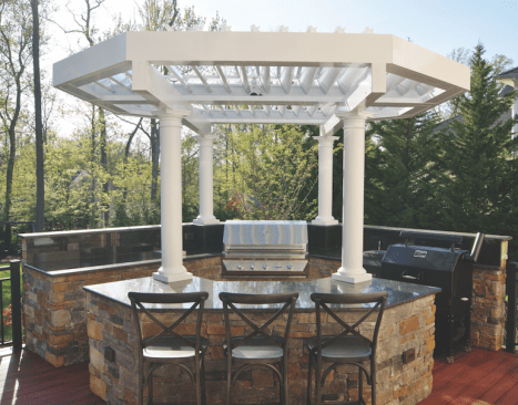

This outdoor kitchen features granite countertops and cabinets faced with stacked stone. Rain or shine, some shelter is provided by an Equinox louvered octagonal pergola, supported by custom PVC columns.
