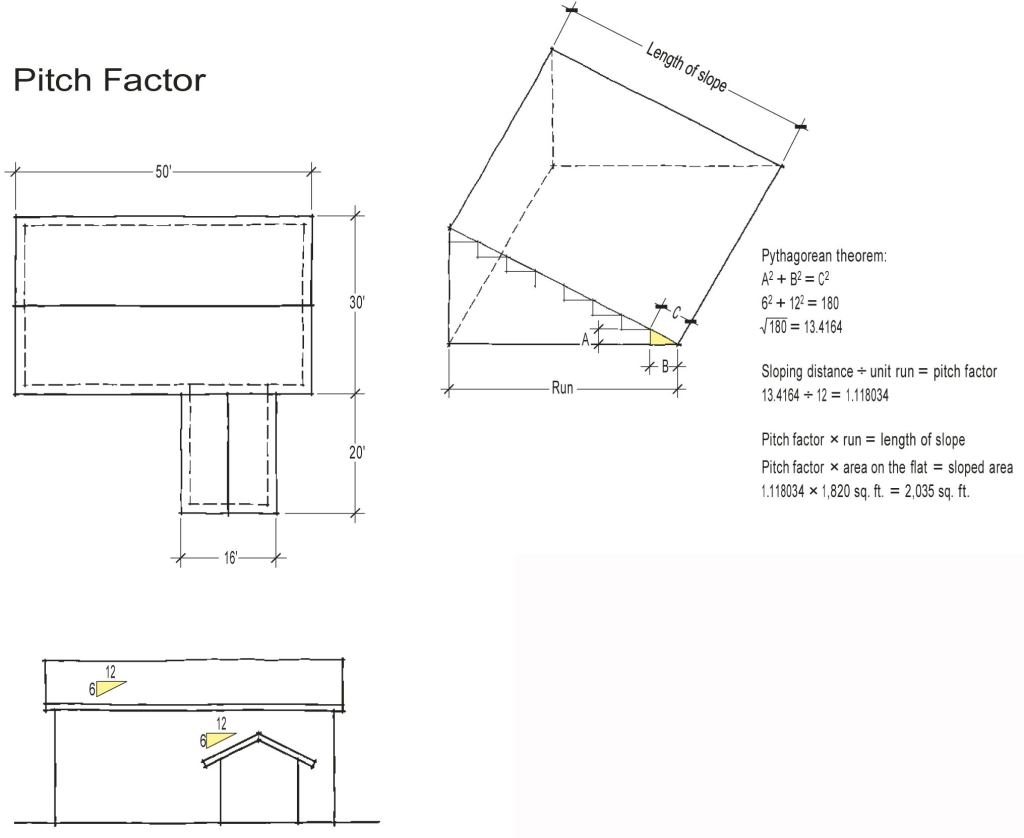

Plans typically show horizontal and vertical dimensions and the slope of the roof. This roof is 1,820 square feet on the flat, but to estimate sheathing and roofing materials it's necessary to determine the area on the slope. First, using the Pythagorean theorem, calculate the slope distance — 13.4164 inches per foot of run for a 6/12 roof. The ratio between this slope distance and a unit of run is called the pitch factor. Multiplying the run of the roof by the pitch factor gives the slope, or rake, distance of that roof. Multiplying the area of the roof on the flat by the pitch factor gives the sloped area of the roof.

The first thing I do when estimating a roof is figure out its area. For the purpose of this article, let’s say we’re looking at a simple L-shaped house with a pair of 6/12 gables. The plans indicate that, including overhangs, the roof measures 1,820 square feet on the flat. But since the sloping area is greater than the flat area, you’ll need more material than that.
You could scale the slope distance from an elevation and use it to calculate the area of the roof, but as an estimator I’ve learned not to scale from prints. It’s too easy to make a mistake, especially when they’re drawn to 1/4-inch or 1/8-inch scale. Plus, if the prints were drawn by hand or subsequently copied, they may not actually be to scale.
Pitch factor. I prefer to put a formula in the template and let the spreadsheet calculate the slope. It’s faster than using a calculator and there’s less chance of a mistake. All I have to do is enter the area on the flat in one cell and the pitch in another, and the template creates a pitch factor, which it uses to calculate the sloped area of the roof (see Figure 1).
The pitch factor is the ratio between the sloping distance and the run. Multiplying the area on the flat by this number gives you the area on the slope. To calculate a pitch factor, start with the Pythagorean theorem:
A2 + B2 = C2
A is the rise, B is the run, and C is the sloping distance. For a 6/12 roof, A equals 6, B equals 12, and C equals the square root of 180 (62 + 122). The square root of 180 is 13.4164. The formula for the pitch factor is:
sloping distance / unit run = pitch factor
13.4164 / 12 = 1.118034
Think of this number as a percentage: Rounded up, it tells us that the distance up the slope of a 6/12 roof is 112 percent of the horizontal run.
With the pitch factor, we can easily determine the sloped area of the roof:
pitch factor x area on the flat = sloped area of the roof
1.118034 x 1,820 sq. ft. = 2,035 sq. ft.
