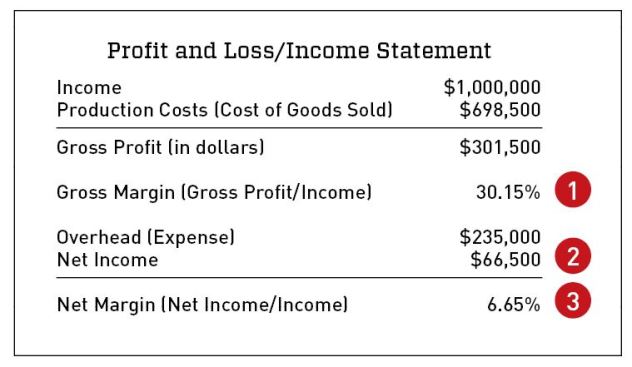

To me, pricing right means that you have determined and achieved targets for one or more of the measurable objectives shown on the sample Profit and Loss statement, below.
1. Achieved gross margin expressed as a percentage (of income); 2. Bottom line (net profit) dollar figure; 3. Net-margin amount expressed as a percentage (of income)
1. Achieved gross margin expressed as a percentage (of income) 2. Bottom line (net profit) dollar figure 3. Net-margin amount expressed as a percentage (of income)

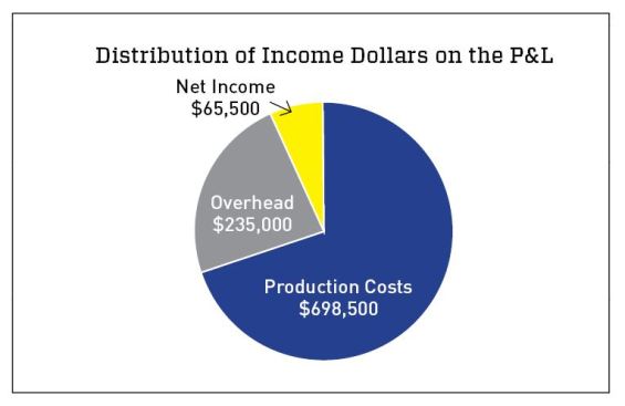

Bear in mind that the only dollars you can use to pay for overhead and contribute to profit are those left over after you’ve produced jobs. If your invoiced costs fail to adequately cover your production costs, your bottom line will suffer. That’s because every sales dollar will be distributed in only one of three ways (see pie chart based on our Profit and Loss statement, below).
If your production costs exceed what you expect, then what will “give” is net income. That slice will shrink and your profit target won’t be met. Similarly, if you have failed to account for overhead accurately, or have added a new expense (such as the salary for a full-time estimator) without planning sufficiently far in advance to allow time to increase markup, then your overhead will expand and your net income will shrink.
Another way of stating this is that production and overhead costs are “non-negotiable” (they are what they are), while net income is “negotiable.” In other words, the net income will be what takes the brunt of cost overruns.
