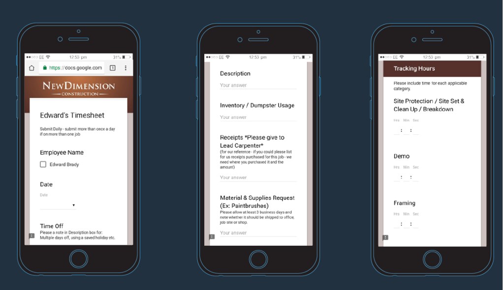

There are many apps on the market for reporting labor hours; one popular example is Tsheets (tsheets.com), which is owned by Intuit, the maker of QuickBooks. But we chose to use a Google-based method because it’s free and it works. The field interface of our labor tracking system—the part we use to collect information from our crew members—is based on Google Drive. Google provides a variety of customizable interactive forms that integrate with the online spreadsheet functionality of Google Sheets. Google’s customizable survey response form offers various ways for people to respond: drop-down lists, check boxes, multiple choice questions, text boxes—you can even take a snapshot with a phone camera and upload it to the drive.
Kristen has modified Google’s simple template with questions and response options appropriate to the work our people do. Using that form, our workers can punch in their total hours worked each day, along with a simple breakdown of the time spent on particular tasks. (They can also let the office know about any materials and supplies they need—an added capability that often comes in handy.)
Kristen updates the form as necessary with a current list of jobs in progress and the various tasks that might be happening on those jobs. She emails each worker a link to a version of the updated form that is personalized for that individual; when workers click on the link, the form opens up on their smartphone. They can pin the form to their phone’s screen so it’s available any time. Then, at the end of every day, our workers on each job take out their smartphones and fill out their forms.
The customization helps. As a business manager, I’ve come to understand that too much information is worthless. With labor tracking, there’s a risk that you can get lost in the details and give yourself so much granular information that it’s confusing instead of clarifying. So it’s nice that Kristen can tailor the Google forms to suit our information needs. Even on a large project, I prefer to use big, broad categories: “site protection,” “demo,” “framing,” “tile,” “cleanup,” and so forth. You could get bogged down wondering, “Was that cleanup after demo, or cleanup after framing?” Or, “Was that wall layout, or building headers, or what?” But my system doesn’t ask my workers to split hairs.
I also let my people know that I’m not asking them to track their time spent on any of those broad categories to the minute; recording time on a task to the nearest half hour is fine. When I use the information later—to estimate future jobs, for example, or to assess whether the current job is on track and predict when it will be completed—I think in terms of “worker days,” not worker hours. I’m certainly not thinking about worker minutes. When my people are reporting to me, the nearest half hour is close enough.

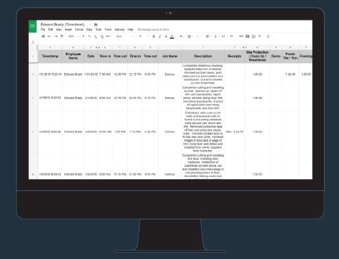

Google Forms automatically dumps to a Google Sheet, the spreadsheet capability of Google Drive. That’s the “back end” of our information-gathering system. Every day, all the reports from all our workers show up on one Google Sheet that Kristen can view on her desktop computer. Every Monday morning, she starts her week by opening up the Google Sheet to work with the labor data from the previous week.
Labor reporting “back end.” Daily hours reported by the author’s employees on site dump directly to a Google Sheet in the cloud, which the company’s office manager can view on her desktop computer. Total hours for each employee, hours spent on specific tasks, and descriptions or comments from the employees all appear in an organized format, in a continually updated permanent record. The office manager then copies and pastes the information into Excel for processing and analysis.

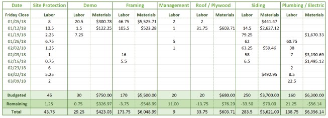

We typically have anywhere from two to five jobs going at any given time. Kristen’s Excel “sort sheet” lets her take each worker’s individual reported hours and allocate them to the different jobs that person worked on that week. Then, she can assemble a report for each job, listing all the work performed on that job by all our crew members that week. She goes on to break down that labor time based on categories of work: demolition, framing, tile, finish, cleanup, and so forth.
Labor tracker. The customized Excel spreadsheet form shown above helps the author review his ongoing labor and materials cost for each job on a weekly basis. In the example shown, framing labor and materials exceeded the author’s estimate, as did labor in the “Roof / Plywood” category. Noticing this kind of pattern in his weekly review of the job numbers helps the author catch problems early and make adjustments.

Every Monday morning at that routine meeting, I familiarize myself with the progress on each job. I can compare the actual labor time so far for each phase of the job with the hours I had allowed for that work. If we’re 10 hours over budget on framing, I’ll know it. When there’s a discrepancy, I’ll ask the crew—what happened here? Did I get something wrong? If I see that we’re falling behind on a job, maybe I can make an adjustment to catch us back up.
