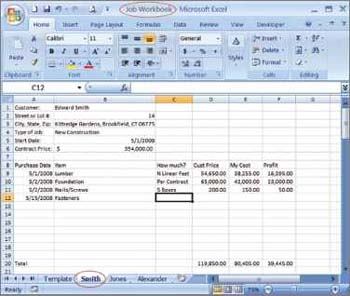

A Simple Worksheet
A worksheet has numbered rows and lettered columns. The intersection of a row and column is called a cell; each cell has a name, such as A1, B1, C1, A2, A3, A4.
In the example (below), the workbook is named “Job Workbook” (at top, circled in red). It’s the single file that will contain all your projects. The worksheet being viewed is named “Smith” (at bottom, circled in red). And the selected cell address is C12.
The “Smith” worksheet uses simple formulas to track the cost of materials, the amount charged to the customer, and the builder’s profit. An addition formula adds up the invoices for materials as you accumulate them. A subtraction formula calculates your profit. You always know where you stand financially on a project, without having to pull out the calculator every time you add an invoice.
Once you’ve mastered the basics, you can make your worksheets as elaborate as you like. For instance, the items can be broken down into detailed categories such as decking, framing, and railing. In a single worksheet, there are several million cells, so it’s nearly impossible to run out of space for the material lists you will be creating.
