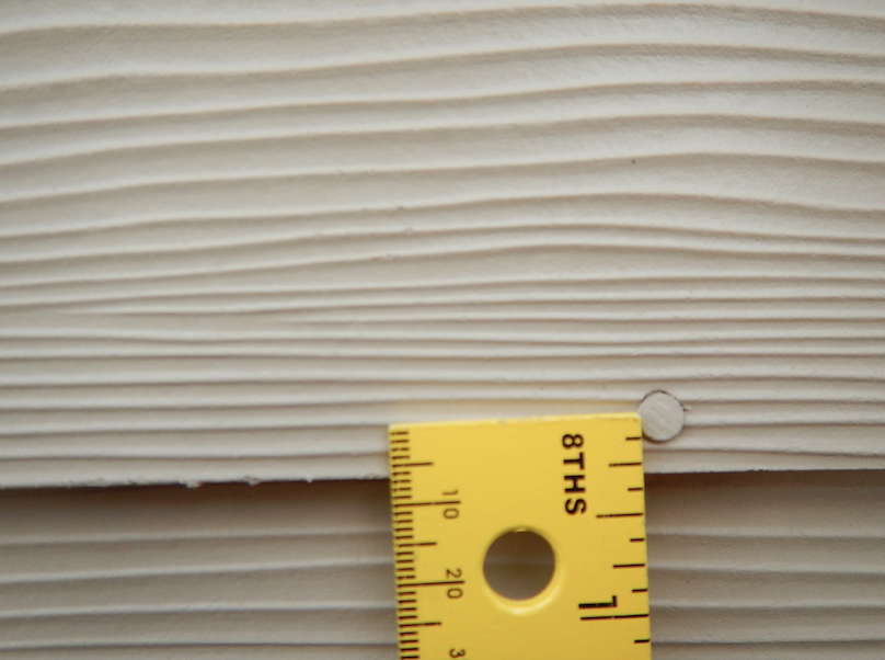

1. When face-nailed, exposed fasteners must be placed at least ¾ inch up from the bottom edge and usually no more than 1 inch, as the typical overlap (and the overlap specified in the IRC) is 1¼ inches.
2. When blind-nailed, nails typically must be placed 1 inch down from the top and set with the nail head flush to the surface. The nails shown below are much too close to the edge and overdriven, so they are providing very little resistance to negative wind pressures or to the material’s tendency to move with changes in temperature.

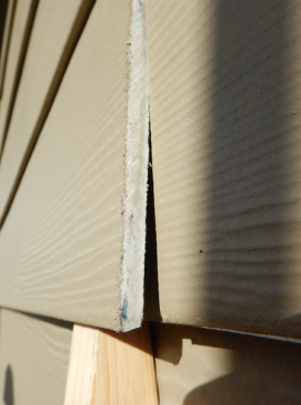

3. Fiber cement won’t rot, but it is not completely impervious to water. It can absorb water at unprimed ends and edges. The absorption and drying of water, combined with freezing and thawing, will gradually cause the material to deteriorate at vulnerable edges. Most fiber cement-siding manufacturers require that cut ends be primed.

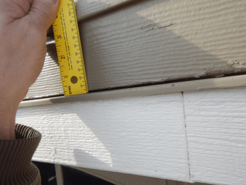

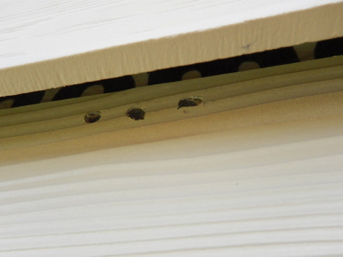

4. All fiber-cement manufacturers specify minimum clearances where siding hits a horizontal surface, such as above the head trim of an opening. At least ¼ inch is typically required, and this gap should remain uncaulked to allow water that gets behind the siding to drain out. (Equally important, though not shown, are the required clearances above slabs and decks—typically 2 inches—and the clearance above roof surfaces—typically 1 to 2 inches—at wall-roof intersections.)

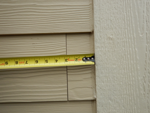

5. Butt joints must typically be located over the studs—a detail spelled out in the ESR and in the code. Tiny pieces like this are doomed to fail. Elsewhere, this house was framed on 16-inch centers, while many of the butt joints were offset by 24 inches—a clear sign that many joints were unsupported.

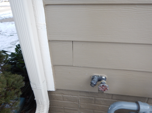

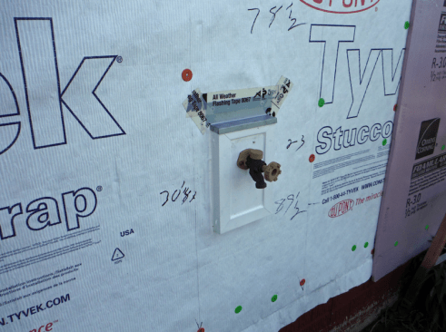

6. Replacement installers will often just slot siding boards around penetrations. This is exceedingly poor practice because the only defense against a leak is the caulk, which is good for only a couple of years at best.
Mark Parlee
7. The correct way to detail any penetration is with a split mounting blocker or a product like those from PlyGem or StrudiMount. The top edge of a split block should be either beveled to drain downward or flashed. (Note here that this wall is being prepared for fiber-cement siding with StuccoWrap—a crinkled housewrap that provides a drainage space behind the siding.)
