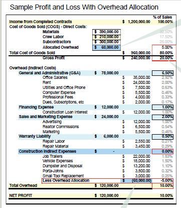

This sample P&L represents a construction business with three employees in the field (including the owner) and annual gross sales of $1.2 million. In order to allocate the overhead expenses that vary according to job size — so-called “Construction Indirect Expenses” — the owner has moved those costs above the line to Cost of Goods Sold. To balance the statement, the same costs are posted to a negative, or contra, overhead account.

I’ll suggest two approaches. With both methods, you continue to code these variable costs to overhead accounts, but you also charge them to specific jobs — in other words, move them above the line. But to keep your books balanced, you’ll create an additional negative, or contra, overhead account where you will record the reallocation of the variable costs as you post them above the line. So, for example, you would create a pool of all your vehicle costs, including maintenance, fees, insurance, fuel, and so forth. Separate these costs as you normally do in the overhead section of your P&L. Then, create another account, a contra account for these variable overhead expenses, where you post the reduction of overhead as you charge them to jobs (see sample P&L, previous page). You can do the same for cellphones and small tools — or any overhead expense item that fluctuates with volume.

One way to allocate these costs is to add a labor burden item through your payroll system that adds on a specific dollar amount or a specific percentage of every labor dollar. The same amount would be posted to the contra overhead account, which carries a negative balance — similar to a liability account used for payroll taxes. The net effect will be to increase job costs while reducing overhead.
So what number should you use? One strategy is to use last year’s numbers to come up with an educated guess. For example, say you spent $3,000 in small tools last year. You and two employees worked all year, clocking 2,000 hours in the field. Therefore, the figure you would add to your labor burden would be $3,000 · 3 · 2,000, or $0.50 per hour. This is how much it costs to cover the small tools that your field staff uses in a year.
If for some reason last year’s numbers are not an accurate representation of your costs, use the dartboard method: Just pick a number and start allocating it to your jobs. After a few months of using that figure, your P&L can help you determine if it’s too high or too low. If by midyear you’ve spent $2,000 on tools but only allocated $1,500, your allocation is too low. If, on the other hand, the numbers net to a negative amount, the allocation rate is too high. In a perfect world, the actual costs less the allocated costs should net to zero, but it’s not a perfect world. As you review your numbers, you can always adjust the rate. Analyze these numbers every few months, and make adjustments as needed.
