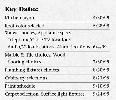

Often, the owner’s failure to make choices or supply material or labor on time can cost you money. For example, say you agreed that the client will supply the plumbing fixtures, and that they must be delivered on June 1. But the client’s brother-in-law couldn’t borrow his uncle’s truck that day and nobody told you, so the plumber and your foreman are there waiting, but the fixtures never arrive. Not only are you out your foreman’s wages and the amount the plumber will bill you for his time, but you now have to juggle the whole job to get things back on track. If you screwed up, you would expect to be held accountable, and so should the client. Make sure your contract clearly lists any responsibilities the client has to supply materials or perform work that will affect your part of the project. The contract should also explain that the client is liable for any additional costs incurred because of delays or other problems due to the client’s failure to meet those responsibilities (Figure 2).
Figure 2. To avoid delays, the author’s project schedule includes “Key Dates” for material selections and other critical decisions required from the owner. A clause in the contract stipulates that if a missed deadline results in additional costs, the owner will reimburse the builder. Change orders. It’s not enough to include contract language to define contingencies – you also need to draw up a change order every time you do additional work or something unforeseen affects the original scope of the project. Include the cost of the change, the revised contract price, and any additional days you need to add to the completion date (Figure 3).
