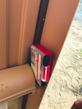

The author’s crew always knows where the first-aid kit is. Until the job is dried in, the author keeps it in the portable toilet. After the job’s dried in, he brings it inside and tells everyone where the first-aid kit will be. Having it on site is a start, but it’s not enough. Everyone needs to be told where it is, at every step of the job.
Jeff Kirby

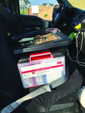

The author also keeps a 118-piece 3M first-aid kit in his truck at all times. It has enough variety of supplies to be useful in a number of situations. Because it is never not in his truck, he always knows where it is.
Jeff Kirby

First-aid kit. During framing, I usually tuck one out of the way somewhere; sometimes the only spot is in the Port-A-John. I also carry one in my truck. Smaller jobs require the typical first-aid kit shown here, but on large jobs, first-aid kits can be as big as or bigger than a roll-aboard suitcase. Once a house or project is dried-in, I move the first-aid kit from its glorious position in the Johnny to a central location inside the house. I then review that updated location during the next site meeting.

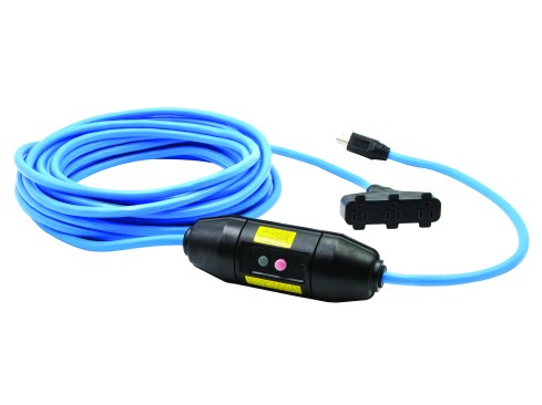

Check the panel on your temporary power first to see if it is GFCI-protected. If it isn’t, then see if the quads are. And if those aren’t, cords like this Bad Ass Extension Cord (above) now come with in-line GFCI protection.

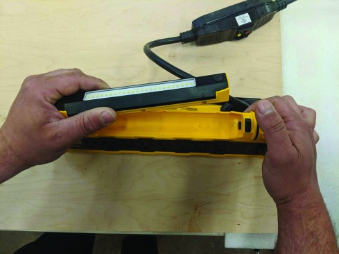

There are also GFCI-protected multi-outlets, like this DeWalt Power Station from DeWalt Shelving.
Temporary power. First, check if the breaker in the temp panel is GFCI-protected. If it isn’t, make sure the quads coming out of it are. And if they’re not, use a cord with an in-line GFCI. I have never been electrocuted, but I have heard it isn’t fun.
