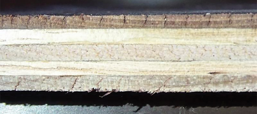

Engineered Flooring’s Veneer Attached … Upside Down?
A wood flooring specialist and a construction-law attorney break down the liability issues when a manufacturing defect is discovered in an engineered wood flooring installation.
About a year after installation, engineered flooring that had been purchased by a homeowner but installed by a flooring specialist began to develop numerous cracks running the length of the flooring. After getting stiff-armed by the retailer that sold him the flooring, the homeowner called in a third-party inspector specializing in wood flooring, who analyzed the installation and determined that the problem – knife checks from the slicing process used to produce the veneer wear layer – was caused by a manufacturing defect. In this interesting Wood Floor Business case-study, a construction-law attorney breaks down the liability issues and suggests a possible resolution to the problem that might satisfy all parties.
