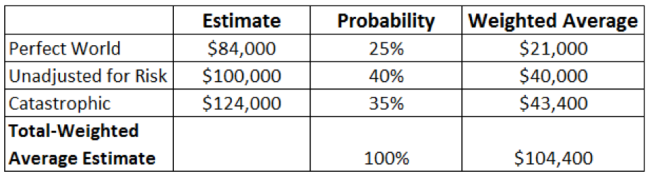

First, come up with an estimate for the job, unadjusted for risk. Let’s say the estimated cost of the project is $100,000.
Next, come up with a “Perfect World” and “Catastrophic” estimates for the same job. This is where your gut and years of experience come in, and where you can consider the likelihood of weather, crew loss, sour customers, and so forth. Then assign a probability for each scenario. For example, you may feel that there’s a 40% chance that the job will run as usual, 25% that conditions will be perfect, and 35% chance that the job will be a disaster. This is where your gut and years of experience come in!
This is how the risk table should look:
Risk table developed by Leslie Shiner and Melanie Hodgdon
Leslie Shiner/Melanie Hodgdon
Complete the Weighted Average column by multiplying the estimated cost by the probability for each of the three conditions. The total of the Weighted Average column reflects the estimated cost including risk. In this example, 4.4% was added to the estimated cost of the job. The final step, of course, will be to add a markup suitable for your company’s overhead and its target profit, based on the total estimated cost adjusted for risk.
