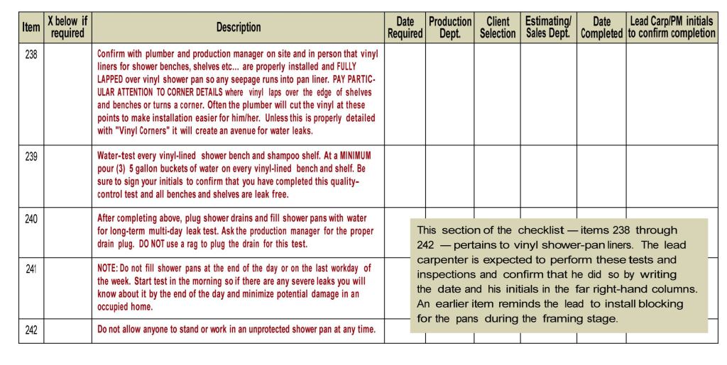

Shower pans. For example, I've seen plumbers lap shower-pan liners the wrong way and then tell me the shower won't leak once the tile is on. A mistake like that is hard to miss, but many smaller errors can be detected only by leak-testing the pan.
I want the leak-testing to be done right, so the list reminds leads to use the proper-size drain plug (not a rag); to test the benches and shampoo shelves; and to fill the pan in the morning so that if there's a severe leak someone is there to fix it.
Addressing this topic on the checklist shows that I am very serious about these issues and that there is no excuse for building a shower pan that leaks.

This section of the checklist — items 238 through 242 — pertains to vinyl shower-pan liners. The lead carpenter is expected to perform these tests and inspections and confirm that he did so by writing the date and his initials in the far right-hand columns. An earlier item reminds the lead to install blocking for the pans during the framing stage.
The notes in the checklist are color-coded so that different types of tasks are easier to identify. Blue items have to do with customer selections and are important to track because they require lead time. Scheduling reminders are in black, material-ordering reminders are in orange, and standard operating procedures are in red.
